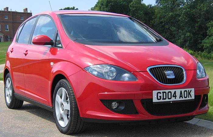

Anyone seen the weird wipers in action on the current Seat Leon/Altea/Toledo? They both PARK vertically next to the A-pillars and then work like a normal claphand system.
