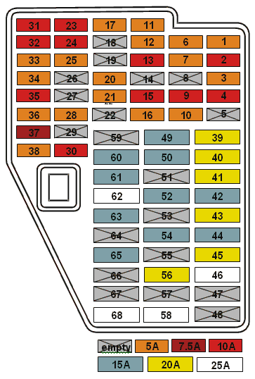

What fuse number is this? I can't seem to find it :(
Does this help?
It's fuse number 9 - Lambda probe, Red 10 amp.
Hope this answer helps?
