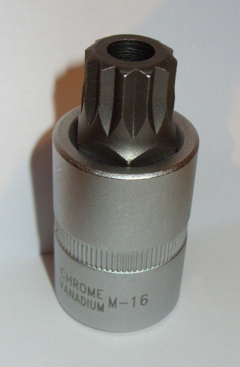

I've got to check the level of the oil in my gearbox at some point, and I was wondering if I needed any special tools (beyond the standard torque wrench) to get the plug out and check the oil level? I seem to remember reading something about a tamper-resistant plug somewhere, but I'm not sure if it was to do with something else?

Special 12 point torx needed, the level plug has an anti tamper type bolt. :wonder:
Information below relates to MK1 FABIA VRS 2005
Cost about £7 or £8 to purchase from motor factor shop.
Sealey SX 107 (12spline) or Draper 63476 HDPK 1 (12 spline) both are 1/2" drive socket type.

I ended up getting the part from a local supplier - Elliotts Tool Warehouse - for £4.70 delivered (my house is on the route between them and the Draper distributor, so they just popped it through the door on the way). :)
