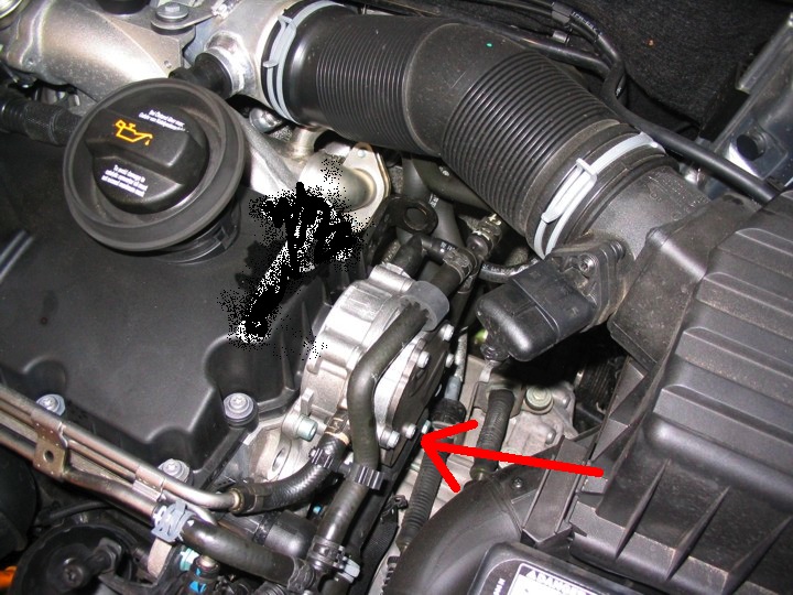

Any one got a Picture of where the Temp Sensor is on the PD130? (Vrs)
i have read loads of forums and they say to the right if the engine bay just above the Gearbox...... i had a look and cant see whats wire from plug
Help please,
If you look just below the tandem pump you will see a T bar arrangement of coolant hoses and plastic T bar. Tucked in behind the rear hose is the coolant sender. It's held in with a spring clip. Sorry no picture, it's all in my head :rofl:
Spring clip? everywhere else has said u clip?!
under the pump looking thing where the red arrow is pointing?
