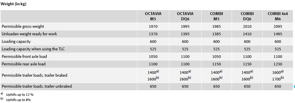

From from my manual
Permissible trailer loads, trailer braked
1400kg up to 12% gradient
1600kg up to 8% gradient
Permissible trailer loads, trailer unbraked
650kg
Here's the table for the 1.9 105hp engine
Hope this helps
Edited by Raglits
From from my manual
650kg
Hope this helps
