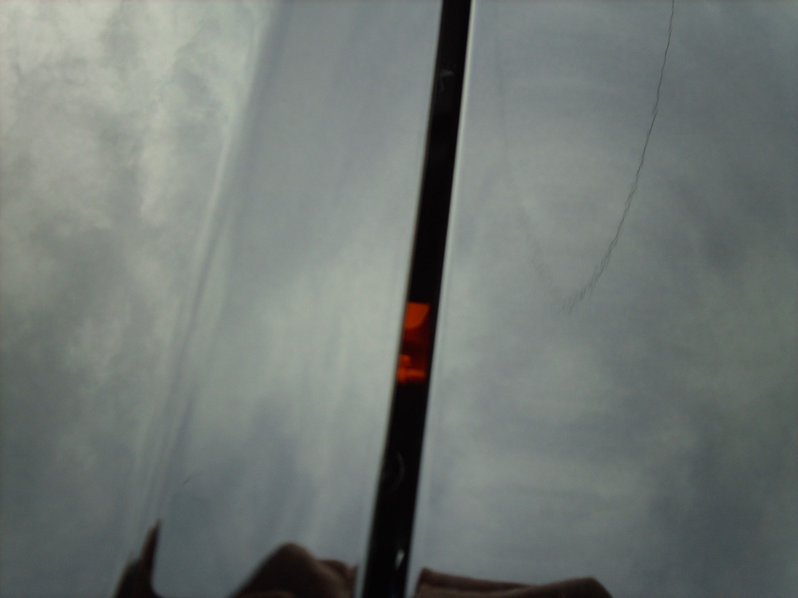

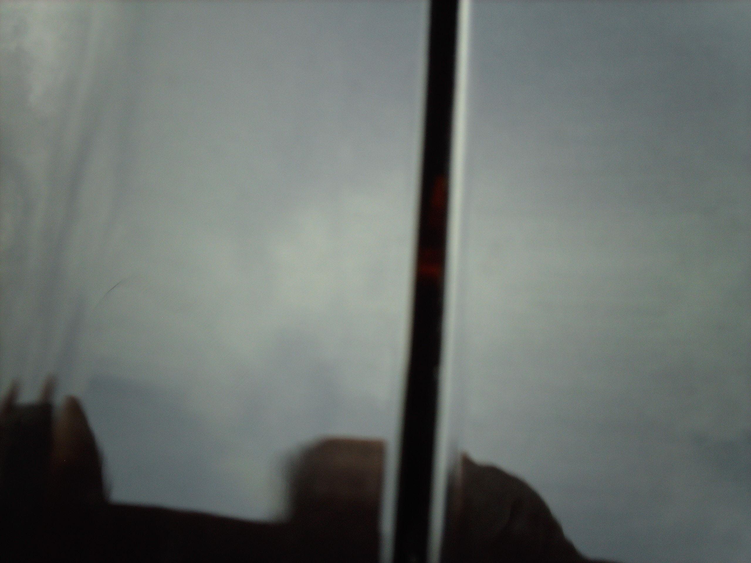

One here for the thinkers. Have a look at the design of the bonnet where it meets the wings - no drain channel as is usual on most cars. They've managed to save 5p's worth of tin.
This looks to me a potential problem for the future from water ingress, as the omission of a drain channel means that water can run into the engine compartment via the gap between the bonnet and the wings. Not a particular problem on the drivers side, but on the passenger side in the engine compartment there are some electrical connectors that seem to get wet, behind and below the general area of the headlight unit.
Any thoughts anyone? This looks like a classic case for a future recall to fit some sort of trim to stop this from happening. On the other hand, perhaps someone knows that this is a deliberate design feature to assist dumping of heat from the engine compartment or something equally bizarre!.

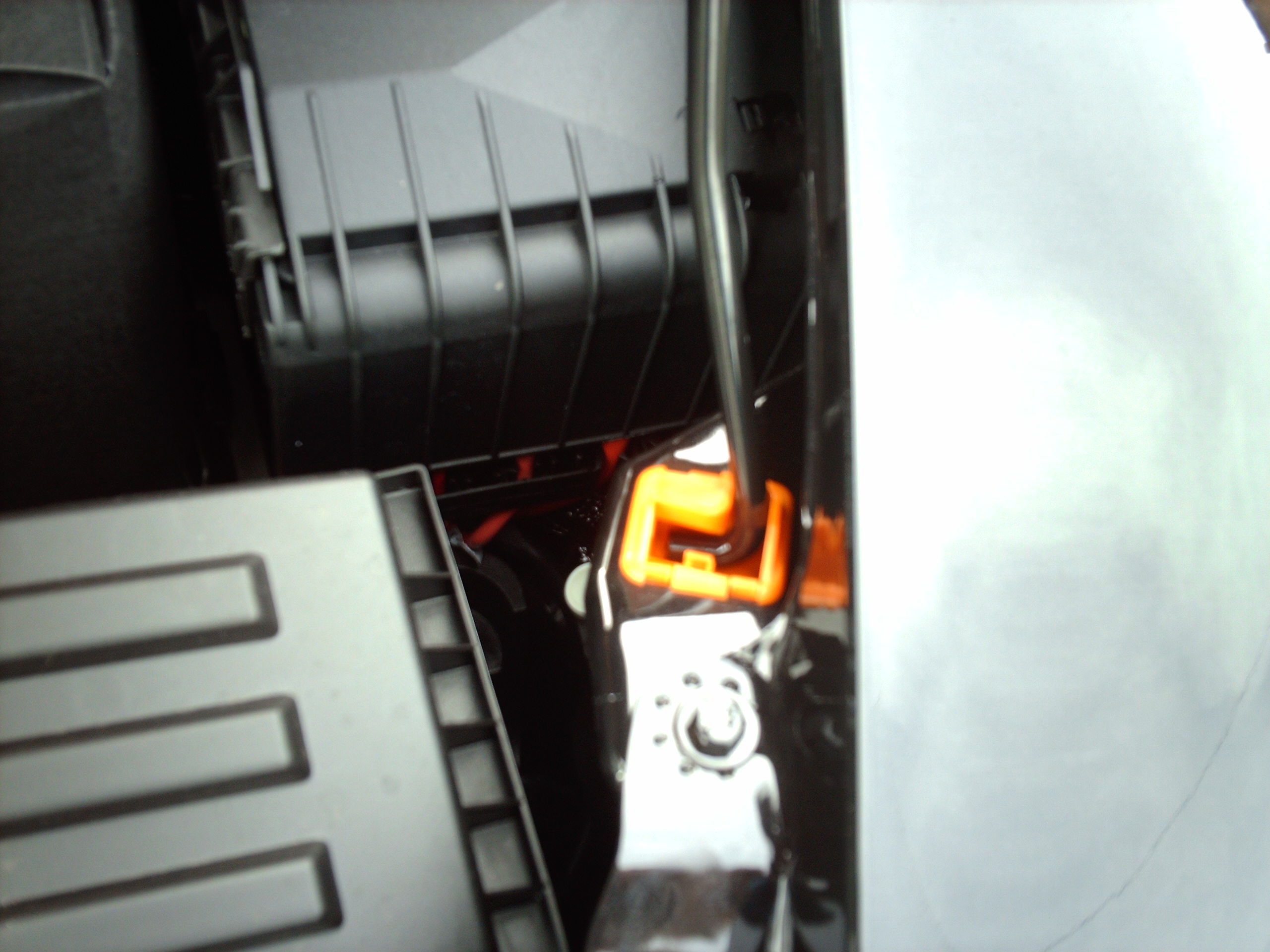

Where I would normally see a water channel to protect the engine bay, there is definately not one there on my 2010 Elegance. In fact, as Skoda have made the point where bonnet stand clips into the frame bright orange, you can clearly see it when the bonnet is dropped, which means there is a chance of water getting into the engine compartment.

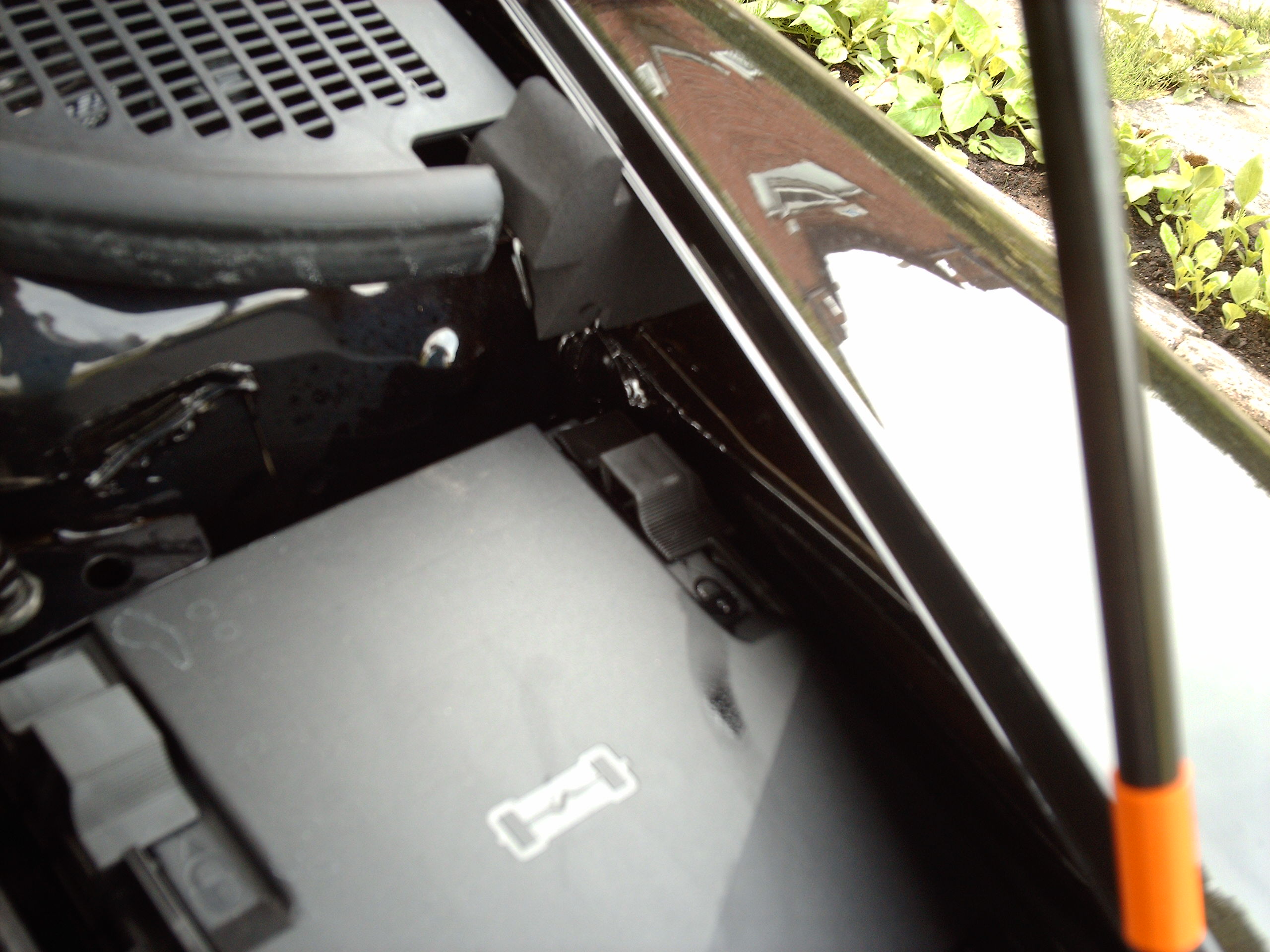

Anyway - just had a downpour with the wrath of Thor and when it stopped I decided to take a peek under the bonnet.
Sure enough, the fuse box was drenched, although I'm guessing it's pretty water tight as I had no electrical issues..

I seem to remember that the design of the bonnet did cause some water problems when the Oct 2 first appeared... somewhere on here I remember reading weird electrical problems. The cause was water getting into the fuse box which sits right under the bonnet closure - I seem to remember that Skoda sorted this very quickly by putting a water proof seal under the fuse box lid ( if you open the fuse box make sure you put the lid back on properly ) and I don't remember seeing anybody mention the problem since. I have now had 2 Mk2 Octavias and although it seems a little odd compared with other designs it doesn't seem to cause a problem. The lack of gutters is not a problem and may even help by allowing rain water to run through, avoiding the sludge and water sitting in corners as it does so often in cars with bonnet gutters. The fuse box issue was dealt with very early and the gutterless design has stayed for 6 years so I don't think you could regard it as a mistake really. What about latest facelift... I wonder if that grew gutters after the redesign of the wing for the new headlamps...
Popped into Eardleys this morning - Their service guy checked this out and said that this is not an issue, as long as the fuse box is replaced properly as it's water tight.. I didn't want him to prove this to me (especially not on my car).
