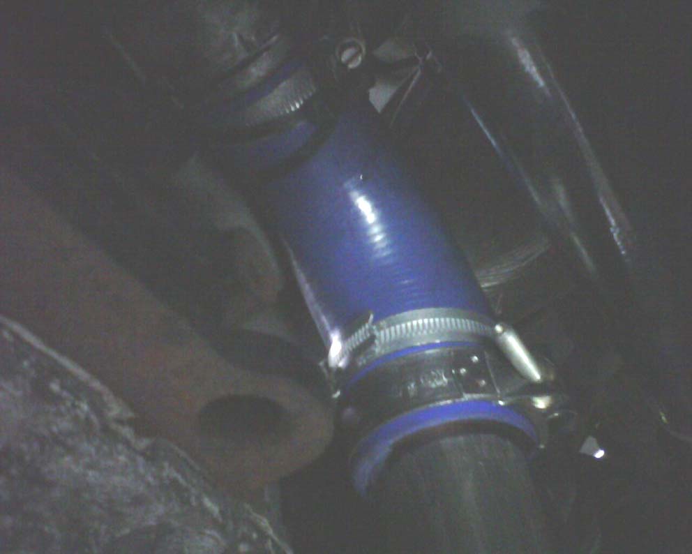

Driving Home, Turned into the road to cover the last couple of miles, Nice long Straight & then a hard sweeping right ... 2nd gear 4500 Rpm, 3rd 4500 Rpm, 4th 4500 Rpm ... Just start to back off to change gear & BANG.. Feck.. :(
No Power what so ever, But still running.. After all the recent Turbo failures on here too i thought .. Oh No not my Turn ...... Managed to coast the rest of the way fearing the worst as i have removed all of the Vag Boost hose connectors apart from the one directly off the turbo & this one is well secured ....
So limps onto the drive & had a shufty ...... Fortunately for me the other end of the samco pipe off the turbo had blown off... Panic over :giggle:
So i brought out the Big Boys :D The Mikalor clamps :D
Lets see how long this one stays on ;)

Nearly all my boost clips are held on with those kinds of clamps. Yet to have a boost hose pop despite 2.2 bar of boost pressure. :thumbup:
Thats good news then ;) The Jubilees are good but they just don't have the clamping pressure of the Mikalors .... Plus they save you the cost of a clean pair of Pants :giggle:
