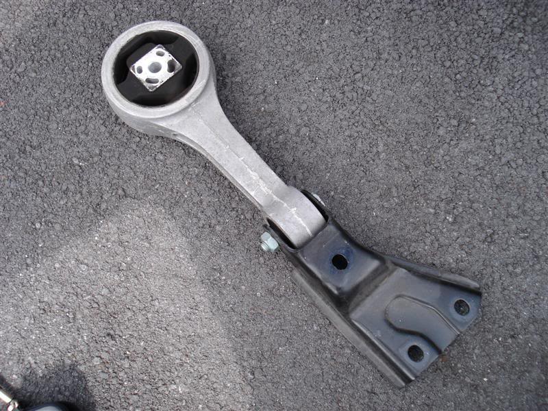

Sounds like 'Dogbone' up the spout, allowing engine/gearbox to rock about.

Dudey it could be dogbone mount which is located underneath the car. The plastic undertray needs to be taken off to get to it. The mount is about £50 i think. Had mine done last month. The other mount that could go is the side engine mount which is found underneath the battery tray(sometimes it might need lubricating with PTFE spray grease)
The other thing it could be is those wishbone bushes (console bushes). They've not been done on your car yet have they?
Also worth checking the wishbones arms are tightened up nicely and there's no movement in them as this as I found out can cause that knocking sound when releasing and dipping clutch or change gears.
let me know how the MOt goes. good luck : B)
Thanks for the pic!
