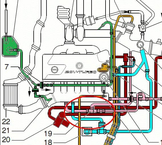

I finally got round to checking my vac hoses and I have a split in the 1cm one that goes from the valve at the bottom of the S-hose you've pictured above to the inlet manifold (the blue hose circled in red in picture below)
It looks like it's been split for months, or even years, doesn't seem to have made a blind bit of difference to the performance but hey I'll replace it anyway. The only thing that bothers me is there's too many other hoses in the way (for the N249 and N112) so it's going to be an ar*e to get the clips off, and those clips are bad enough to get off even if you can get to them!
Any tips anyone?
Any tips anyone?
I find using a small thin screwdriver to slot in between the gap of the top of the clip then twisting it sideways to expand the gap you can then use either the same screwdriver or a second screwdirver to pop up the clip and it will break past the locking point.
Thanks mate, I was thinking that might be the best way. I might remove the battery too to make access a bit easier.
Thats how I did it too.
Yes it is a bit tight with all the other pipes in the way but it can be done :thumbup:
