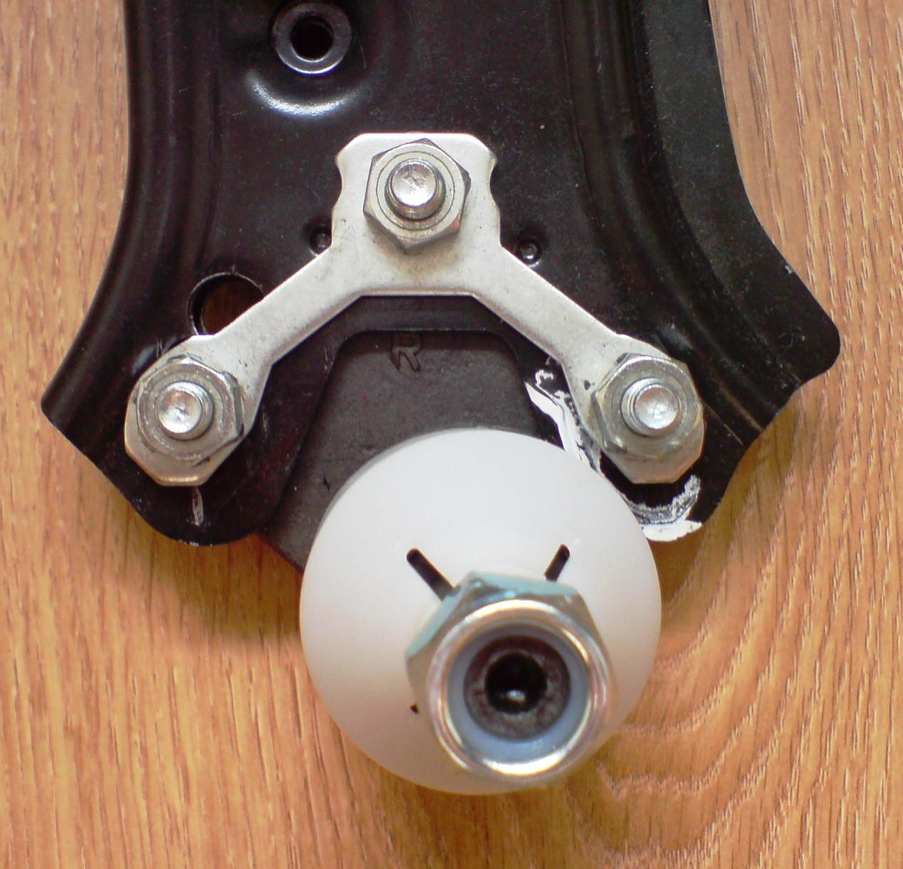

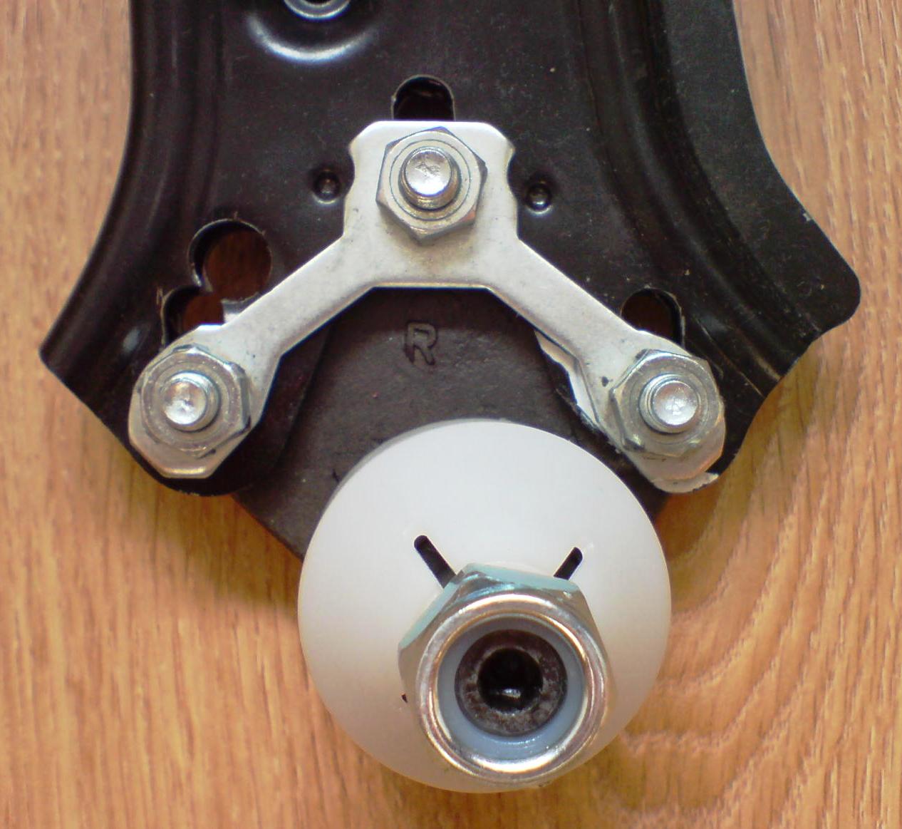

How about one WITH camber adjustments ;)

with the greatest of respect, that is an absolutely shocking bodge of a safety critical component

look, i'm not trying to belittle your efforts here, i think it's great that people think 'outside the box' on stuff like this. but as a qualified engineer, and as somebody who has built kitcar frames, and suspension arms (caterhams etc) from scratch, and yes i have made shocking mistakes in the past which has led to me nearly crashing them.. i can see at least 2 major flaws with this method of relocating a ball joint, plus also a few other minor ones you could overcome with a little thought..
1. there is a small amount of lateral play allowed in the location of the balljoint due to the fact that it has slots rather than single holes for attaching the balljoint, this could potentially allow for slight changes in the caster angle becuase of the very small amount of coaxial missalignment, i admit that you could cope with this by ensuring the balljoint is properly centred both sides of the car whilst setting it up
2. don't underestimate the amount of torsional forces applied to the track control arms whilst cornering, a heavy car like a fabia/mk4 golf puts a lot of sideways pressure on that joint even under normal cornering, and i'd be suprised if those 3x M8 bolts could clamp that firmly enough to prevent that from stepping inwards under compression, or pulling outwards under tension whilst cornering, not to mention that having the slots there makes the arm weaker... but as you righly say i've not seen this, or been involved in the deisgn process so i could be wrong... i'd just hate to see somebody's balljoint pull out with obvious consequences

like i said before, well done for trying to find a solution to what is probably a common issue with the fabia, i never really had much hassle with camber on my lowered fabia.. i guess that you are trying to add just a smidge more positive camber to balance out the tangential change in geometry caused by the wheel/hub being in a relatively higher vertical plane to a non lowered car... fwiw my money would go on designing a modified top mount with the top damper mounting hole offset slightly off centre towards the side of the car to give you the extra positive camber, this would also have some nagative downsides as well i admit!..
edit: just another thought, is there not another balljoint from a different car you could use instead with similar dimensions? most of the late vw balljoints have the same 3 bolt mounting pattern, there may be one with the balljoint slightly closer in?
