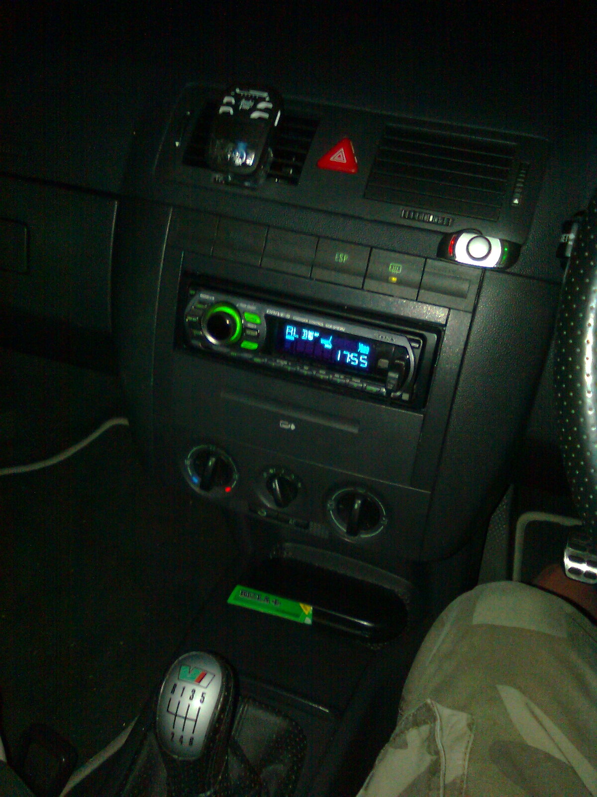

Here's my effort. B)
I had this Sony Xplod unit in my last car (VW Bora)
Then took it out and put it in the Fabia when I bought that..
Luckily, it has red or green illumination so suited either car.
Its almost the same colour/texture plastic as the OE unit
it sits slightly proud as stated above but only just.
Hehehe.. much prefer the function of these cubby holes than the original :rofl: :
