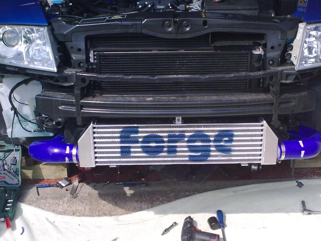

Ive got a forge twincooler fitted and the one you are looking at look different on the mounting points to me i will try and atach a photo of mine for you to look at. as for power gains you will see no power gains as such the only thing you will notice is you will not feel any power loss on hot days as the twin cooler realy keeps intake temps low, my vrs with the other mods done performs as well on hot days as it does on a cool damp day, Very impressed with mine and would definately reccomend a forge twin cooler to anyone. bearing in mind this one of mine is a petrol vrs but as far as i am aware the mounting points for the cooler is the same but the pipework will be different. Hope this helps Phil.
that looks fair nice Phil, did it cost much in total...
any other pictures from a bit further back..

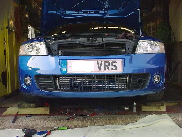

Going down, hopefully on Monday to get the car up in on ramps to see how much work it's gonna take ;) don't think it should b too bad, looking into linking the new one into the bottom hoses of the existing one :D my stainless guys a genius lol lol lol
