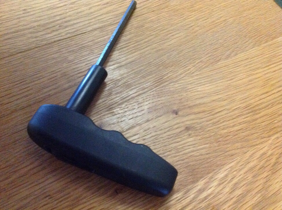

Can anyone let me know how the torque wrench supplied with a set of genuine Skoda Octavia 2006 hatchback roof bars is supposed to work? Bought a used set off a Briskoda member today. The torque wrench looks like this :
It doesn't look exactly the same as mine, which is a T shape where as yours is an L shape, but as you tighten up it will eventually click and feel like something has slipped or given way inside the wrench when you get to the correct torque and that's it done.
It doesn't click , all that seems to happen is the steel Allen ket comes out of the plastic holder when it starts to get tight? Is that as good as it gets. I have torque wrenches for refurbing motorbikes which do the slip/click thing but pretty sure they won't be accurate down to the torque setting required for a small Allen bolt as this.
Anyone else have the same torque wrench as mine?
Or the instructions for these model roof bars.......pleeeeeease !?
