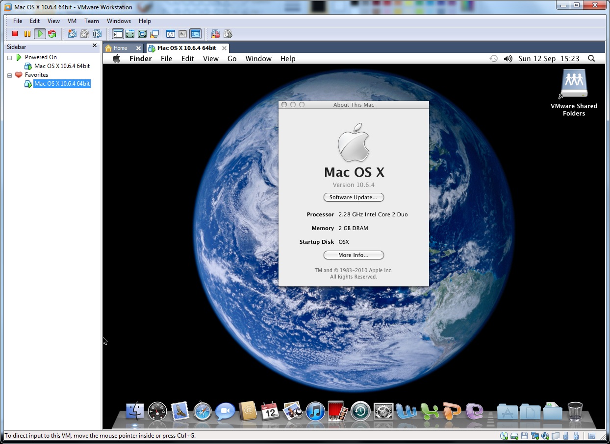

Yay , it works (almost)
Followed the info in this thread.
http://www.insanelym...howtopic=220750
and have successfully installed OSX 10.6.4 in a VMWare Workstation 7.1 VM. I have now patched it all up to the latest version of everything and it works like a charm. Runs fine in full screen (1920x1200), screen dump shows it running in a window.
There are however 2 caveats. For some reason preview does not work and no 3D graphics acelleration.
You need the retail OSX Snow leopard install disk, the ones shipped wiith a new mac dont work (tried my MBP OSX 10.6.3 disk and no go).
The biggest headache is getting the drivers installed.
