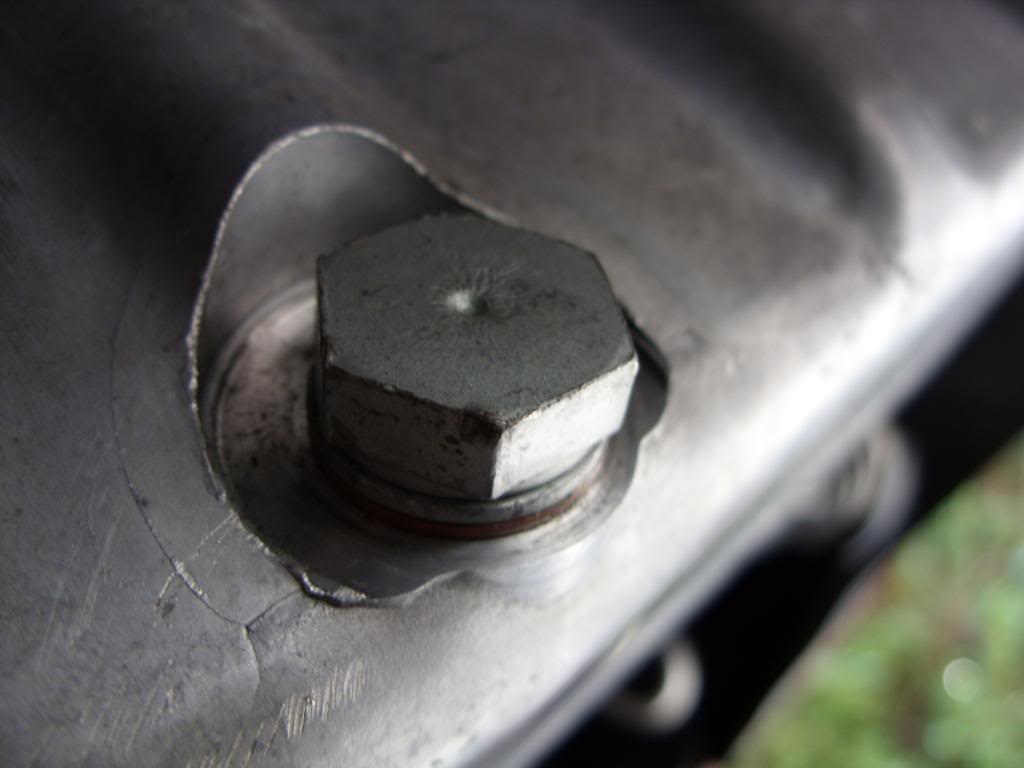

Looks like you have two washers on there, surprised its not leaking.
Those 19mm bungs should be replaced. The 1.2 and 1.4 MPI have bungs which are reusable and require a copper washer.
Yes it does look like two washers, but only a copper one is fitted.
Base of sump plug design only looks the shape of a washer, from the outside.
I think it's shaped possibly is to have a better fit onto the copper washer.?emoticon-0105-wink.gif
