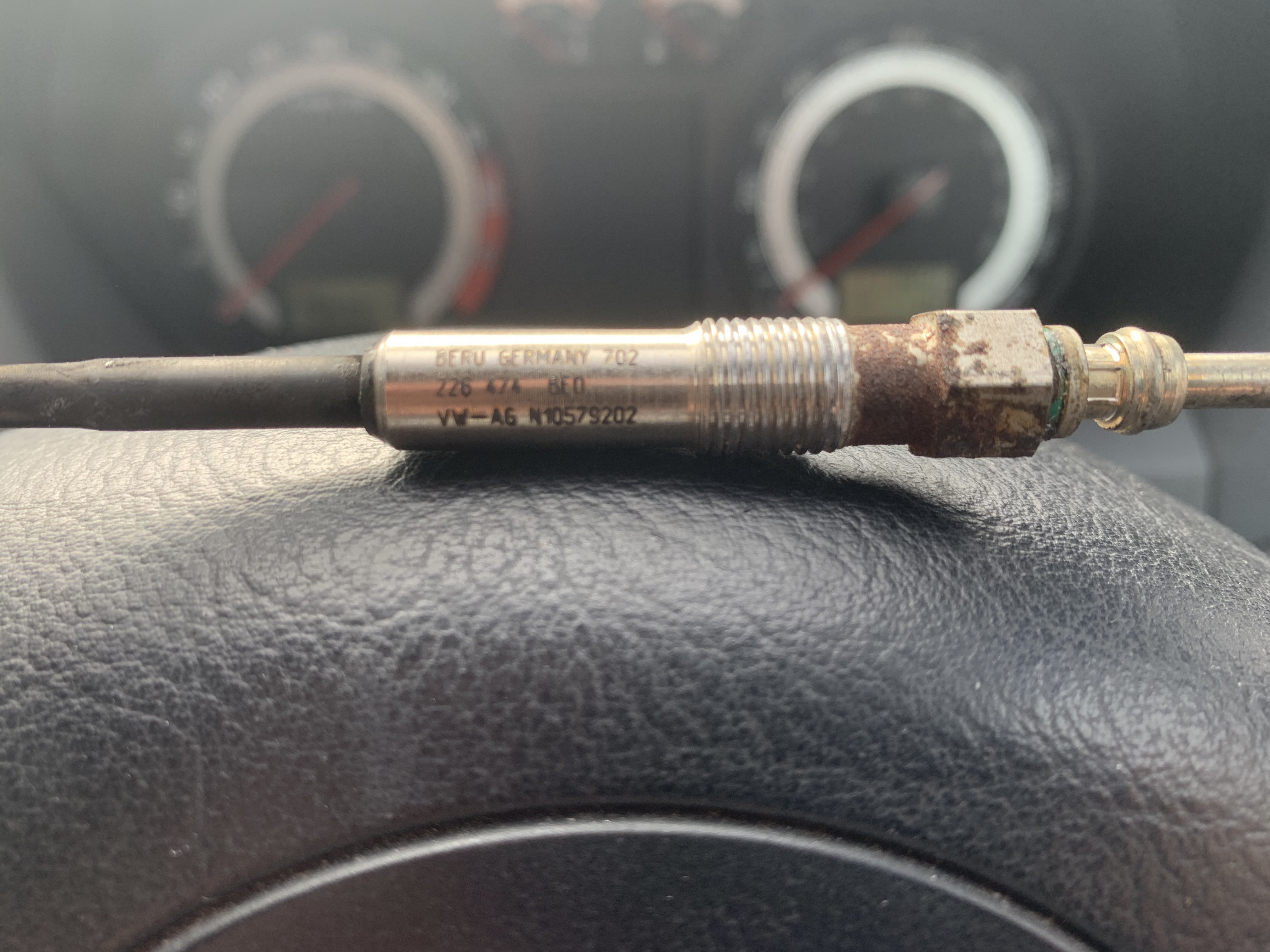

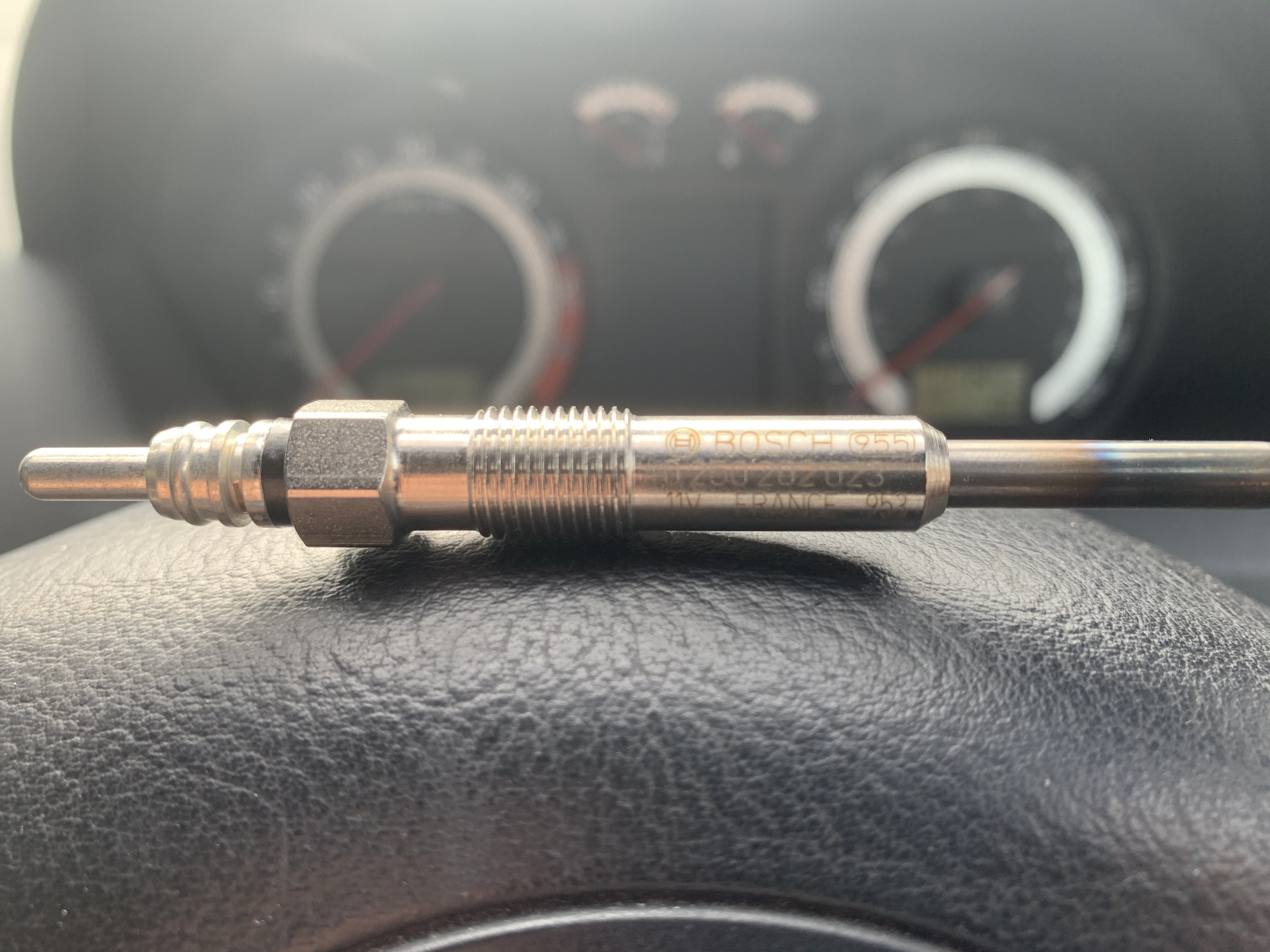

Anyone around that can confirm these are ok?
Old one doesn’t show any voltage.
New shows 11V
Ordered from ECP and they showed as correct when I put my reg in.
As long as the thread fits and the length is the same then it doesn't matter, a 12V glowplug is a 12V glowplug.
i wouldn't think 1volt in 12 (nominal ) would make much difference. Possibly better as in worst conditions, ( weather where monkey seeks blowlamp) battery might just be a bit low .
New shows 11v
It's not voltage you should be measuring, it's resistance.
A good glow plug should probably be less than an ohm in resistance.
