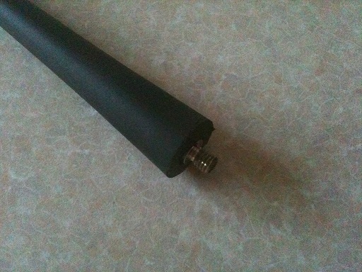

I was unable to fit straight to the car as can be seen in the picture below not enough of the thread was exposed to screw into the aerial base.

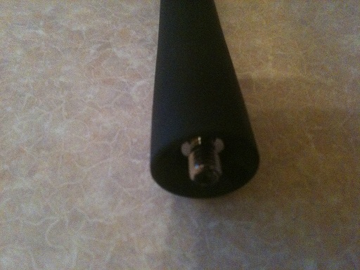

So I trimmed about 5 mm off the end of the aerial with a stanley knife to leave it looking like below.

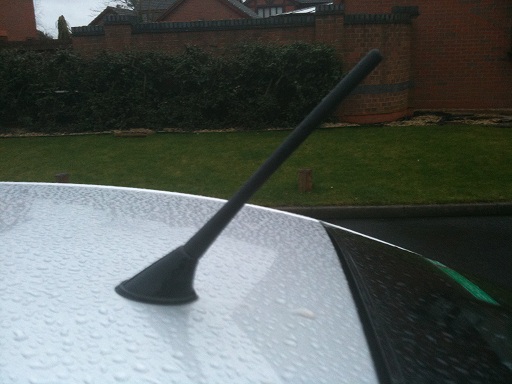

So then I was able to screw into the original aerial base and the end result was as follows

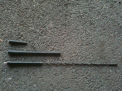

I have attached another image below so you can see the different in sizes of the various aerials, top aerial is the stubby from ebay (totally useless), in the middle new FL Octavia aerial and bottom my original aerial.
The part number of the new aerial is 6R0 035 849 and it cost £11.48 exc VAT.
So far no problems unlike the stubby e-bay aerial, radio reception and TMC with the new FL aerial is as good as my original aerial. WIll update over the next few-days if there is any change in this.
