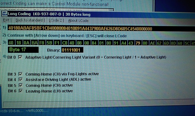

Also
Get cornering lights enabled for your fogs.

Do you know how? I have looked through VCDS and can't seem to find any coding.
I have activated the fogs for ch/lh lights, they are nice & spread the light to the front of the car well :)
I'm waiting for a screenshot showing the coding too, because this is news to me on a pre-FL :)

With Fogs here too. Have a look but mine is FL Scout.
Yes, this isn't a problem to code with an FL example, as it has a different version of the convenience model.
It's not possible with a pre-FL, unless someone (silver1011?) can provide information and screenshots to the contrary.

Yes mine is a FL.
Mine also has the week 22 changes of 2010 and the corner lights will not activate with the blinker.
Still haven´t managed to find out why. Others after week 22 have the same issue.

@alberg
It's a very simple VCDS activated option!<br />Be glad to help if required!!!

@alberg
Happy to receive the help.
Just to let you know that like CEPI replied on post #11, I also have ticked BYTE 17 BITE 0, and still does not work~.
It works only with steering wheel, either left/right over 90º angle.
If their is something dif. PM me
