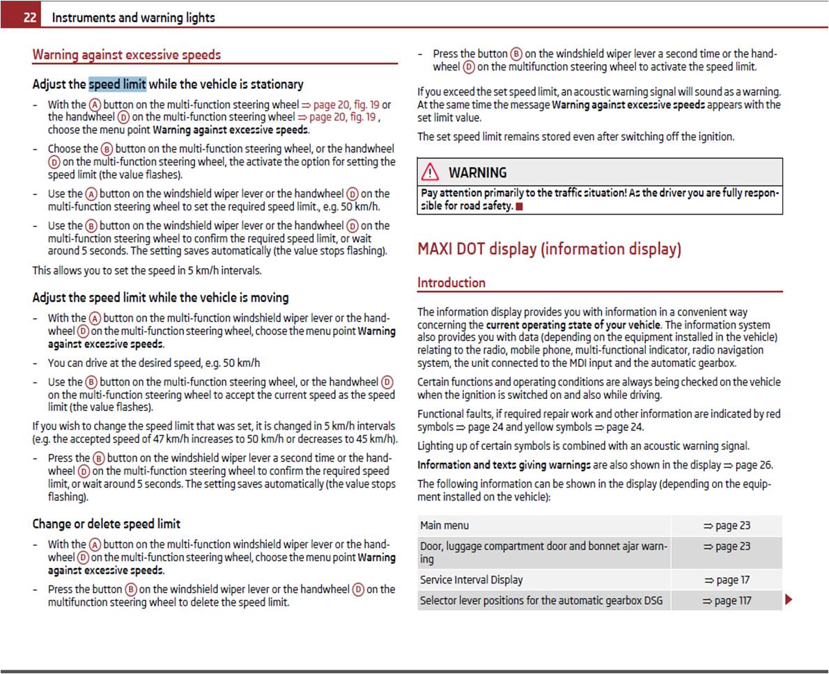

There are actually two speed warnings that you can adjust via the maxidot, both are described in the manual:
  • Page 23 "Warning against excessive speeds"
  • Page 27 "Winter tyres"

Erm, yes...  don't set it to begin with.  Or follow the manual in how to deactivate it.   :giggle:
