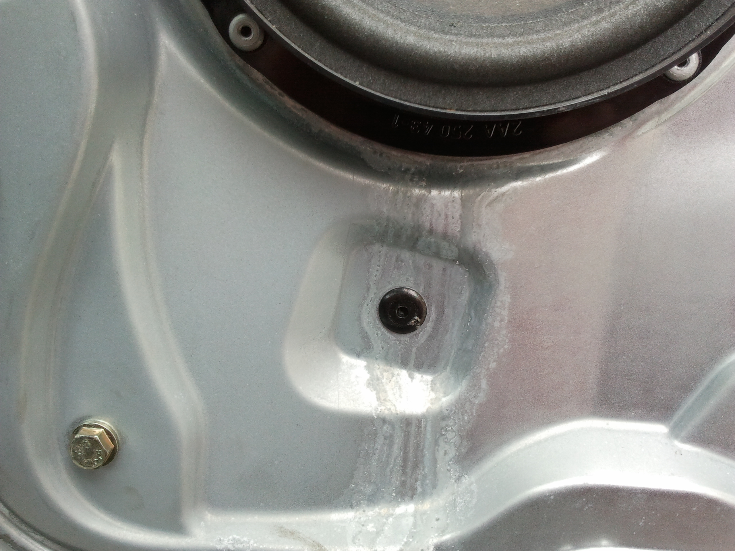

Did my fronts earlier on today to discover it has been leaking via the front speaker, Drilled out the rivets and resealed with sillycone.
I don't recall reading about the speaker leaking, so just a heads up.
cheers mate :thumbup::)
Mine leaked from there on the drivers side with aftermarket speakers and MDF spacer rings. Though the MDF has been liberally coated in PVA, they went mouldy. Replaced them with marine ply and put some sealant around inside, and it seems to have been fine since :)
Did put sealant around the whats it like the rear door fix too just incase...
