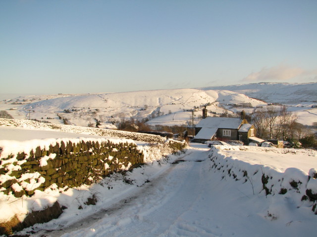

I'm choosing to buy some next winter, not least because this is the road to my house, halfway up a Pennine hillside, and because I'll drive out to the Alps to ski a couple of times during the season.
