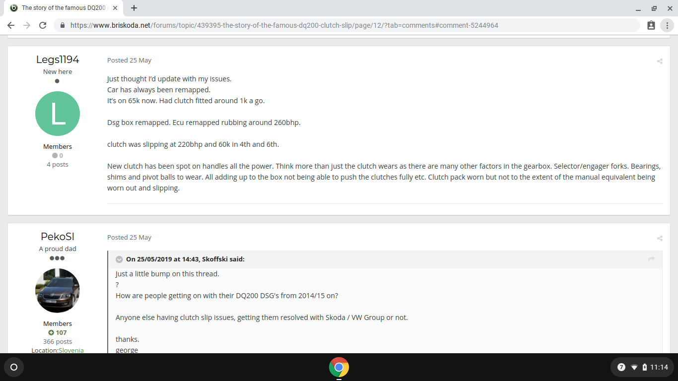

Is it a Mk2 Fabia vRS that you have with around 260 BHP,
and if so what is done to it already giving you Stage 2 + / Stage 3 ?
Edited by Roottootemoot
9 hours ago, Roottootemoot said:
@Legs1194
I have an upgraded air filter
Airtec intercooler
R8 coil packs. Iridium plugs
Decat. Full custom exhaust
Hybrid turbo
I'd call it stage 2+ now as theres much more powerful options available.
