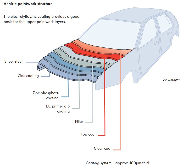

When you read the Technical Documents on the MK4 Golf, VAG put on something like 7 layers of paint!! Is there the same amount on the SKODA? They have to make it cheaper somehow...

Here is a pic showing the paint layers on the MK4 Golf:
