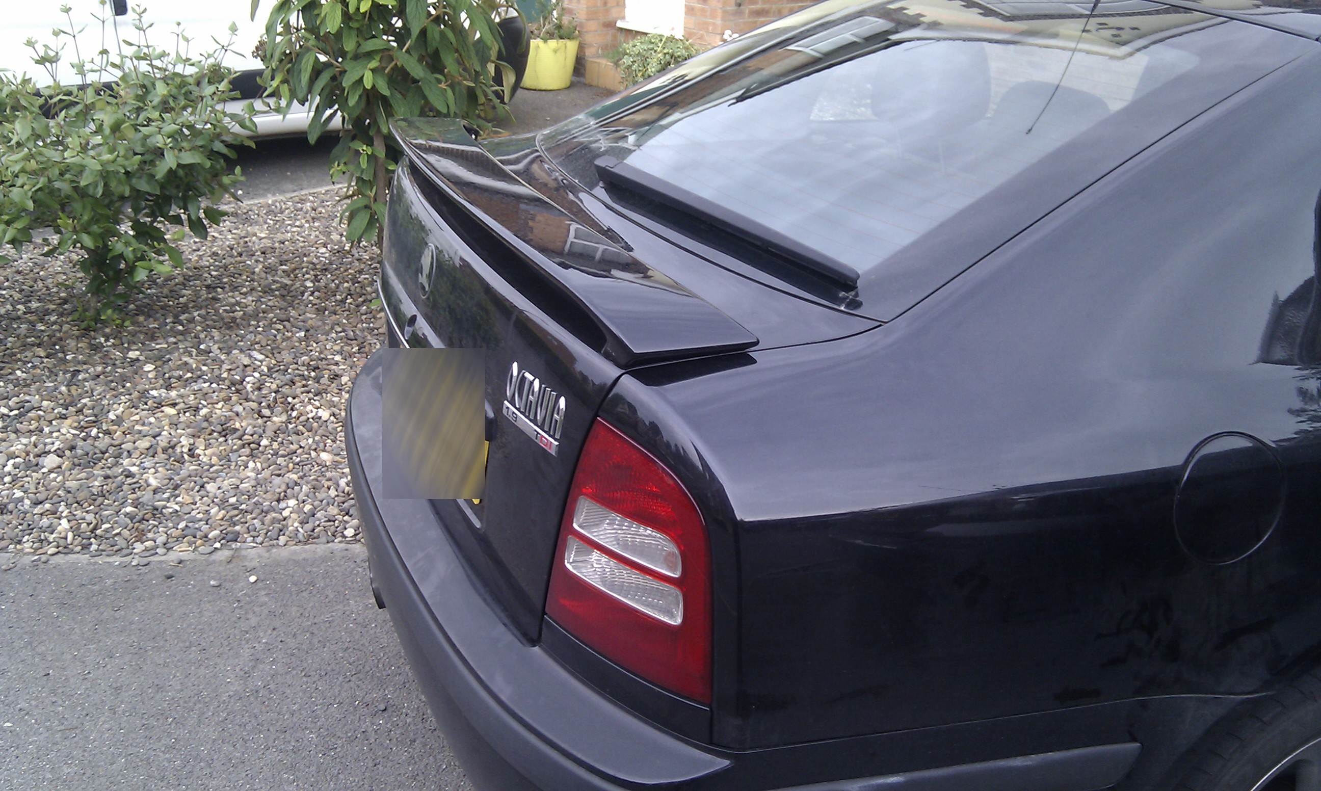

Got around to fitting the rear spoiler I got from billy2981.
Thanks to Raf_ for helping and giving me the confidence to take a drill to my car!! :o

Can I ask how you drilled it, are there marks on the inside of the boot where to drill?
Hi,
No, unfortunately there aren't any holes. Raf_ came over to mine with his vRS and we took a few measurements and a bit of "close enough" before determining the position. We made up cardboard templates of the bottoms marking the hole centre positions, and put them on the bottom of the spoiler, got it in place, then removed the spoiler leaving the templates there.
Even after all that, the holes had to be, erm, "worked" a little to get them to fit.
For final assembly, we got a couple of turns on the thread to locate the screws, leaving about 3mm gap between the underside of the spoiler and the tailgate. I squirted a load of tiger seal or equivalent in there, and tightened the screws down, removing the excess sealant with a cloth.
Oh, and don't forget to paint the newly drilled holes!
Martin
It is easier to have a vrs there so you can take measurements and you can be sure that they are from the same place. The cardboard template was of where the spoiler mounts to the car and only one is needed as each side is a mirror image

Think we kept on measuring for atleast 45mins before Martin got his nerve up to drill :rofl:
