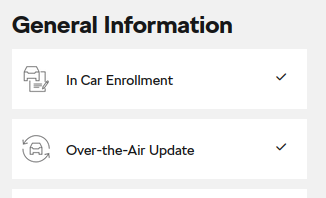

I know there is at least one System update available for my car (confirmed by Skoda), the update of the infotainment software to v1985, but there are no notifications showing up for it and the list in the infotainment showing available updates is empty.

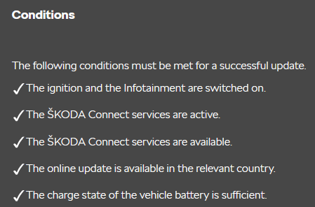

I have fulfilled all the requirements listed in the manual in order for OTA of Online System Updates to work:
  • I have the Skoda Connect app on my phone and am a registrered user
  • I am registrered as the primary user in the infotainment and am welcomed as such by the infotainment everytime I press the ignition
  • The ignition and the Infotainment are switched on.
  • The ŠKODA Connect services were activated in the vehicle.
    • See below
  • The ŠKODA Connect services are available.
    • The globe in the status bar on the Infotainment screen is White
    • In the service management dialogue of the infotainment system, the service "Online System Update" shows as active and the option "Allow in vechicle" is ticked
  • The vehicle has an internet connection.
    • See above. I've tried using both e-sim as well as Wifi (using my phone as a hotspot), each for 4 hrs straight
  • The Maximum privacy is not set in the vehicle.
    • I have tried all of the other three settings related to privacy
  • The online update is available in the relevant country.
    • As mentioned before (v1985), confirmed by Skoda
  • The charge state of the 12-volt vehicle battery is sufficient

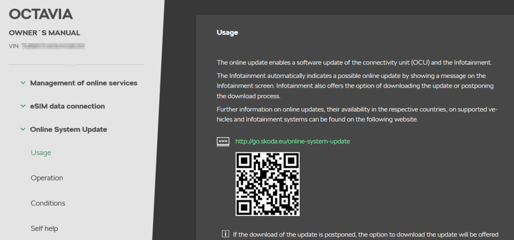

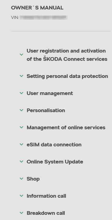

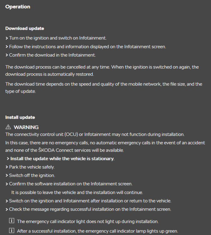

  • The manual associated with the VIN of my car clearly states that OTA of Online System Updates is a feature available in my car
  • The workshop claims that my car should be able to install the System Updates OTA that show up in their system as available for my car (distributed by Skoda). This has also been reiterated by Skoda Europe

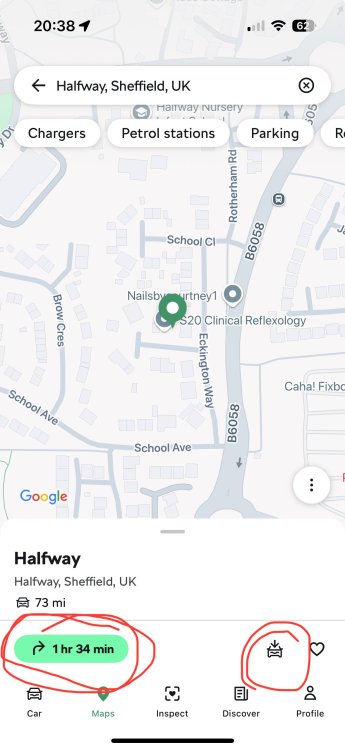

What would be more useful to me is if the feature of being able to send a destination from the MySkoda app to cars navigation system worked. I believe that was a feature that was promised in the original sales brochure. However, it's not something I've seen as being available in the app. So apart from the honk/flash function, the entire 'maps' tab of the app is fairly useless to me.
@JamesK You can send destination to your car via the MySkoda app. You need to go to “Maps” on the app, enter your destination via the search bar at the top, select the correct address.
Then press the arrow with the journey time which will show you the route then you can send to the car. Or just press the car with arrow pointing down and it will just send it. See image of what you need to press.
I can confirm this does work.
Edited by Lowepepsi2004
Yep, we know that is how it is supposed to work, but with older cars like mine and @JamesK it's not available. In my app the "arrow pointing down" to a car doesn't exist. All I get is the usual Apple share icon which allows me to send the route to Apple Maps or Waze. Very disappointing!

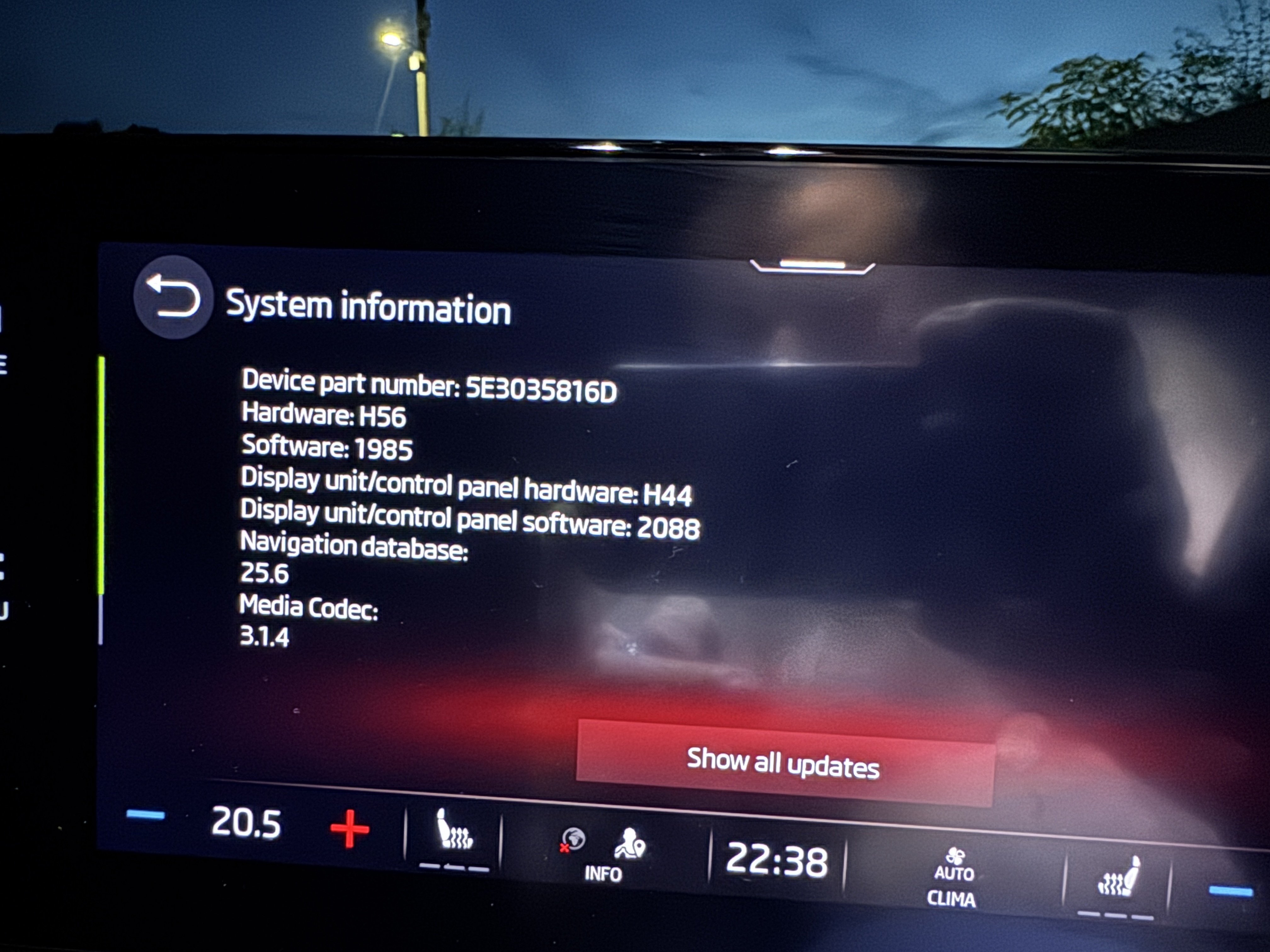

@SteveTheElder mine H56. See attached image also running 1985 OTA back in Jan/Feb
Bizarrely mine has a higher part number and is a 2020 build yet no OTA updates and can't upload a route form the app to the car.
Edited by SteveTheElder

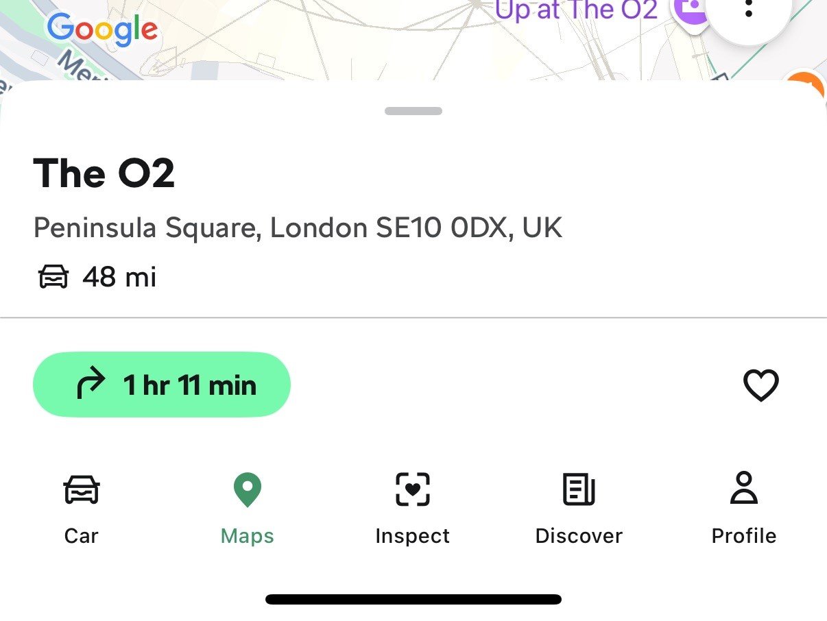

Here's the view I get in the MySkoda app after selecting a destination. As you can see there's no option to send the destination to the vehicle:

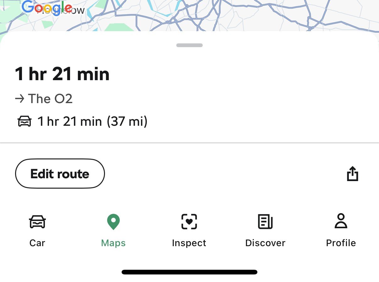

@JamesK what do you get when you press 1hr 11min button on your image, does it show you the route and change to send to car?

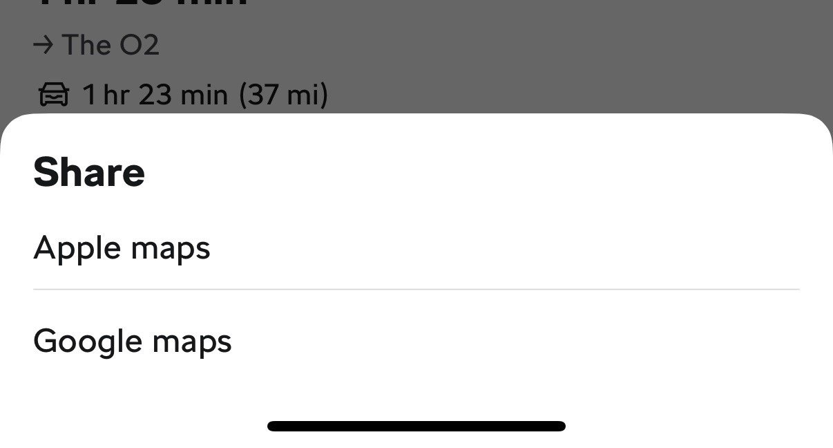

@Lowepepsi2004 It just does as @SteveTheElder mentioned... you only get the usual Apple "send to" button showing:
Tapping it just gets you this...
... which is completely useless functionality as I could just use Google/Apple Maps in the first place! 😄

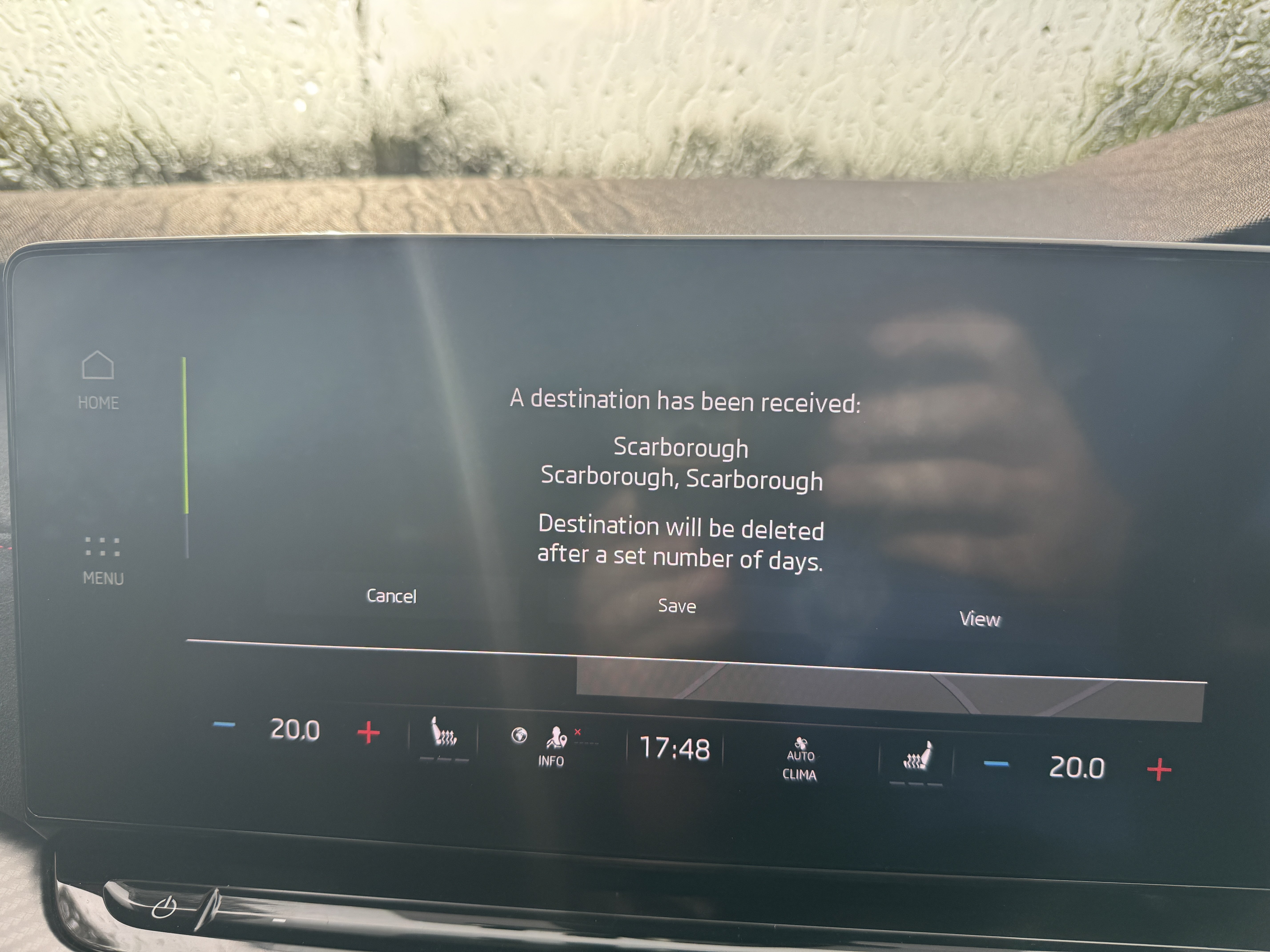

@Lowepepsi2004 can you send a destination to your car as well as routes? I'm thinking its easier to sit on the sofa with the app finding a list of road trip stopovers, for example, and then send each to the car where they would hopefully show up as favourites or recent destinations.
@SteveTheElder ive never tried to send multiple destination so don’t know how it would manage that. As soon as the car start it pops up with the destination.
Just gone out to the car and sent 2 destination only the 2nd one displayed. Then you do get the option to save to favourites, cancel or view route with the option to go.

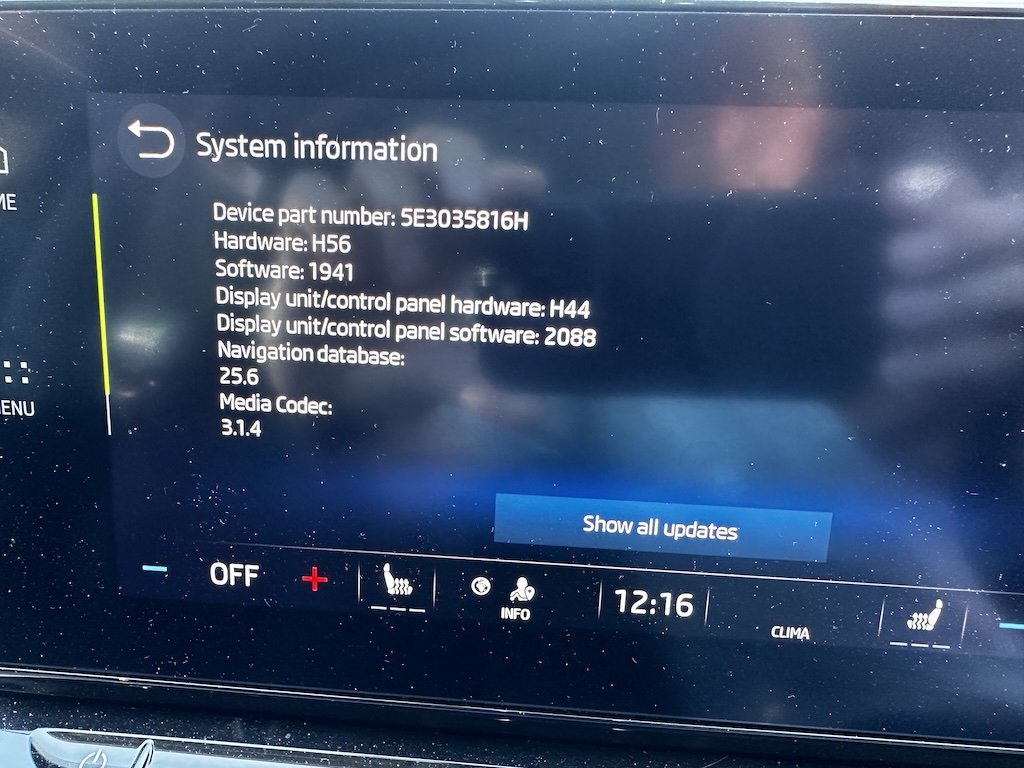

    3. What is the Device part number and Hardware displayed in your infotainment? (see Settings/System Information in your Infotainment)
      Answer: 5E3035820D, H56

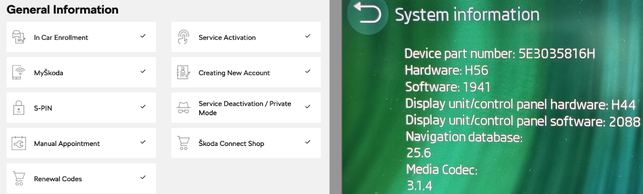

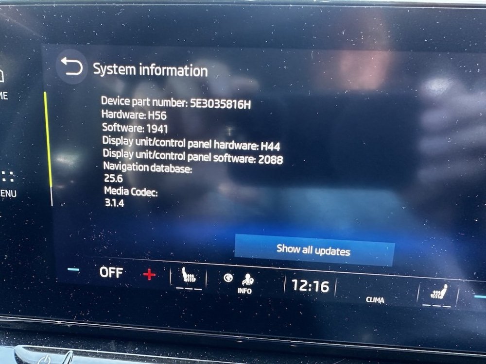

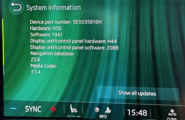

My details are as follows:
Online Manual Instructions Followed for Enabling OTA:Yes
OTA Update shown on Skoda-auto / General Information Page: No
Hardware Version: H56
Device part number: 5E3035816H
Current Infotainment version: 1941
OTA Updates currently being received for:
Infotainment: No
Maps: Yes
Apps: Yes
Here's the relevant screenshot from skoda-auto and Infotainment system information:
