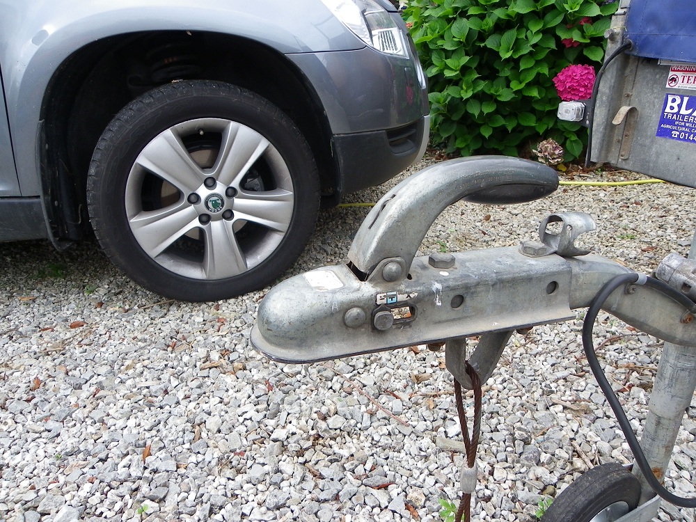

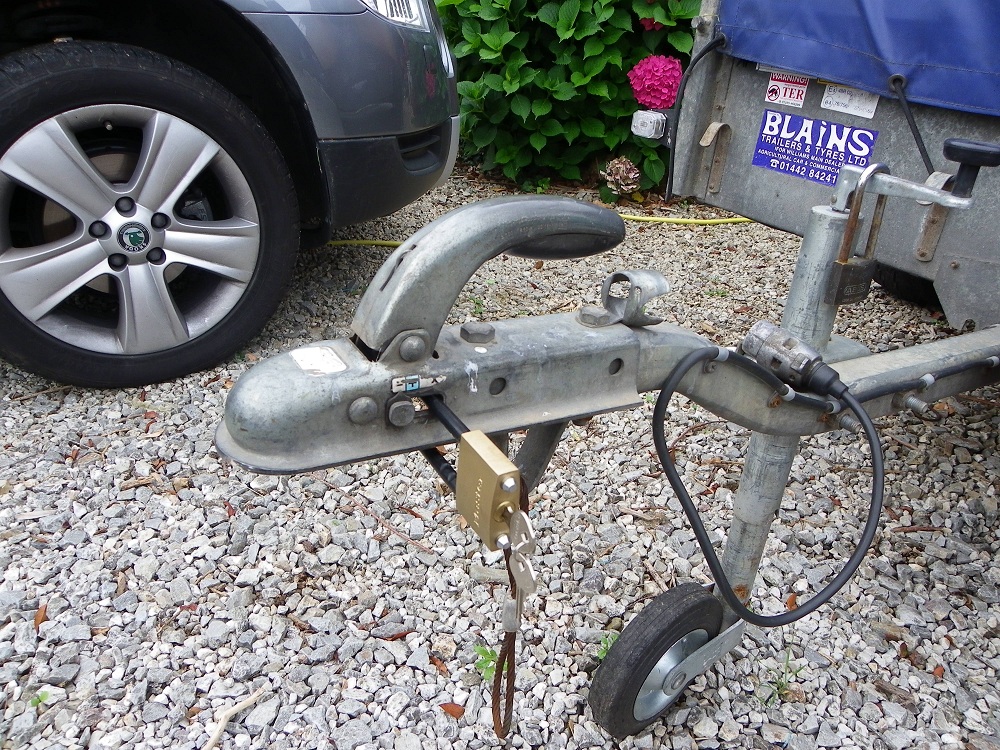

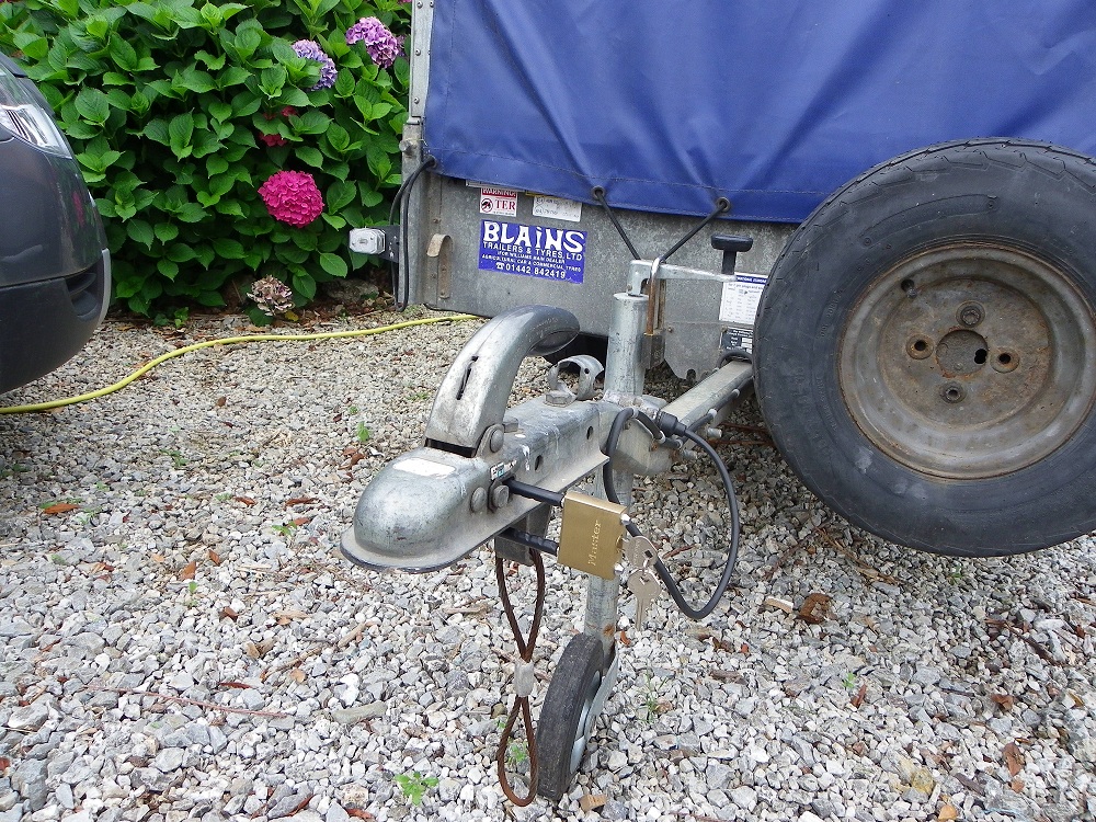

May well have been covered elsewhere on here, but my thoughts on trailer / caravan security attached or parked when using an Alko type hitch.
Using one of these on the towball there is an opportunity to effect some security by using a longstapled(?) lock placed thro' the hitch release slider slot ie when hitched the unit cannot be unhitched from the ball.
Also possible to use the same slot off the car after tripping the loch mechanism ie pull hitch handle upwards, finger under the ballaperture, press the floopy plate and it will trip the handle into the connected position then simply put the lock bar thro' the slot and as the frogs would say et voila!

Only problem with that is that any 'passer by' with an undersized tow ball (yes they do exist) could just drop your trailer onto his/her vehicle and ...gone!!!
You need to use at least one of these http://shop.al-ko.co.uk/products/safety-ball.html or if you have a proper Alko type hitch (most caravans do) one of these http://shop.al-ko.co.uk/products/security-device--aks-1300-.html depending on which stabiliser you have fitted of course - I ALWAYS lock mine onto the car when I am towing, it's double security - against theft when stopped, and against it ever coming off.

But the hitch is firmly attached to the ball with the lock in situ - normally use a 75mm staple Abus lock!
I take you poit when loose so to speak - a simple solution to this problem would be a £10 ball lock inserted in the hitch then the lock thro thr Alko bit. - this would not however stop anyone with a dry b*llick lift on the back of a lorry nicking it - how far security wise do you go??
