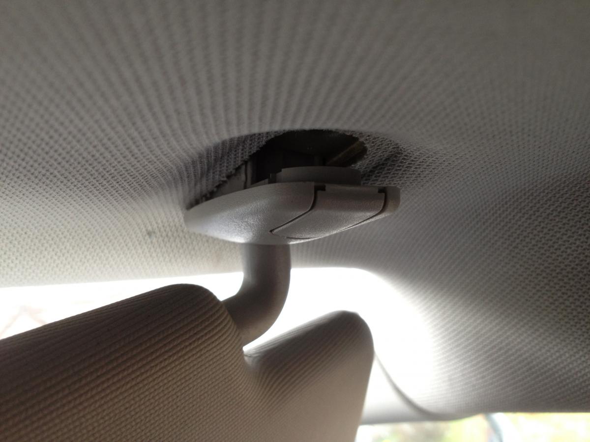

I'm really struggling with this at the moment!
I'm stuck with the 'arm' clip: the side nearest the side windows / wing mirror.
I've flipped the little cover (easy enough) and taken out the screw. The edge nearest the driver/passenger drops down about 1cm and then stops. The edge nearest the windscreen doesn't want to move or come out!
I've tried prodding and leavering with a screwdriver, but its not budging and I'm getting too close to damaging the headlining and visor clip/arm.
What am I doing wrong?
I've worked it out...
It seems to be a question of using 'force' to pull the edge nearest the driver/passenger down overcoming the two small clips that hold it in place.
There is no way the edge nearest the windscreen will come out unless the other edge is out first as there is a much larger tab...
There is a risk of damaging the small tabs but as the screw holds this edge in place, I don't see that as a major problem.
