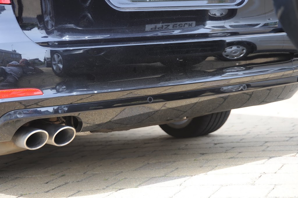

This is the Westfalia tow bar.
Without .........
..... and with
Without .........
..... and with
Ha Ha looks good, both the tow bar and your reflection :thumbup:
