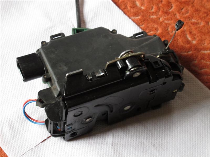

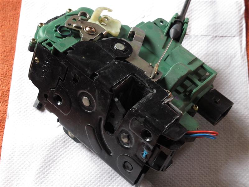

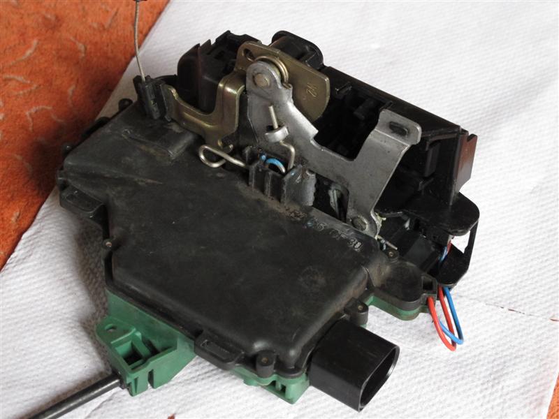

OK guys, well I've pulled it apart and can't find any obvious fault (all the circuitry is intact, tested the microswitches I could get to without opening the mechanical half up, the electric side was fun enough with gears and motors flying everywhere!).
I've come to the conclusion that a new unit is needed (especially as since reassembling this one the inner door pull doesn't seem to be working properly . . . :dull:), plus it sounds a little bit sick anyway so I wonder if it is more than just a connection problem. I am certain, however, that the unit is at fault here, not anything else (e.g. wiring to it through the door) so replacing the unit should cure my problems.

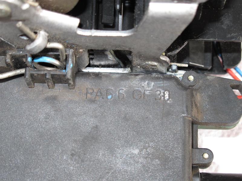

I have two issues now really; firstly is identifying the part number! I've attached some photos, the only thing that looks like a part number is 'PA66 GF30' but that doesn't look like a normal VAG p/n . . . can't find anything else on the unit though! Does anyone else know? edit; some googling suggests it might be 3B2 837 015 L ?

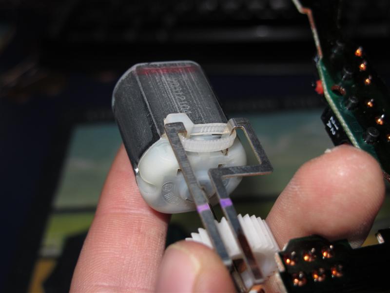

OK folks, well I thought I may as well take everything apart again as I've not got anything to lose, in doing so I managed to eventually find the problem. Not a circuit board issue, in fact, it was an issue I'm not aware has been one before . . . it was the spade connectors on the motor! So I bent them outwards then used a cable tie to tension them, resulting in a better connection. So far, so good!

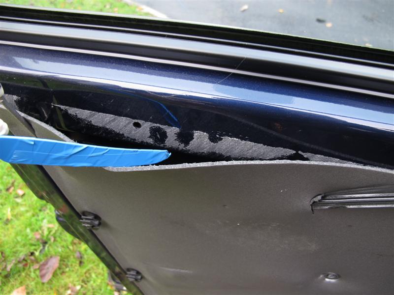

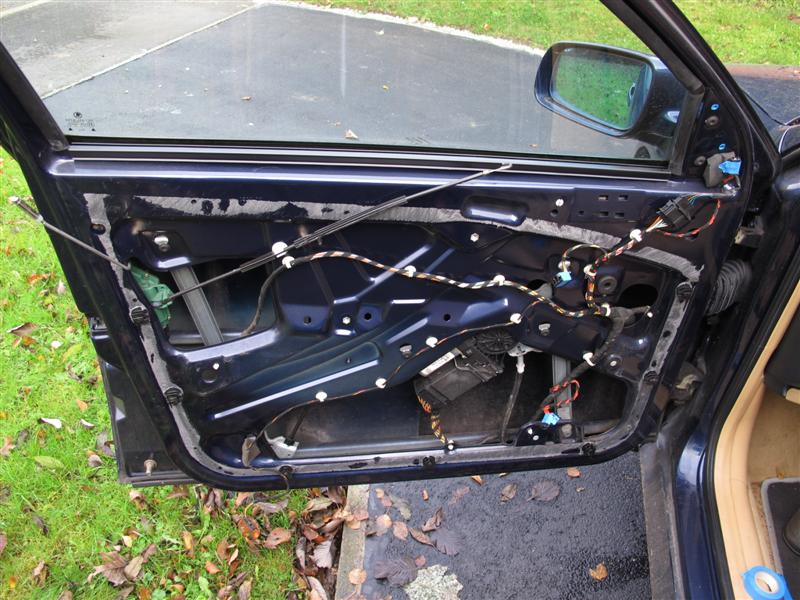

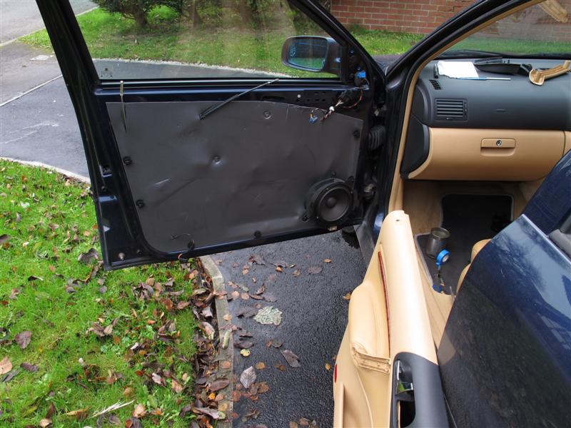

FYI, for anyone following the VW vortex guide on changing this . . . the interior of an Octy door isn't the same as a Golf mkiv; I didn't have to remove the window carriers to get the lock out, just take off two bolts (secured the window with tape though) then I managed to get it out. We do have to contend with a big sheet of glued on foam though (I used an old knife with insulation tape around it to remove the foam, worked well then glue-gunned it back on after) . . . sound insulation I presume? Some photos below anyway should anyone else come across this;
