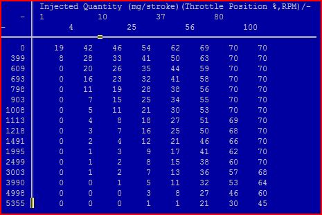

@ Auric
Simple adjustment of this map will give the same effect. So they could have done it all in the map, rather than a map and a box.
@ Auric
Understand thanks :thumbup:
