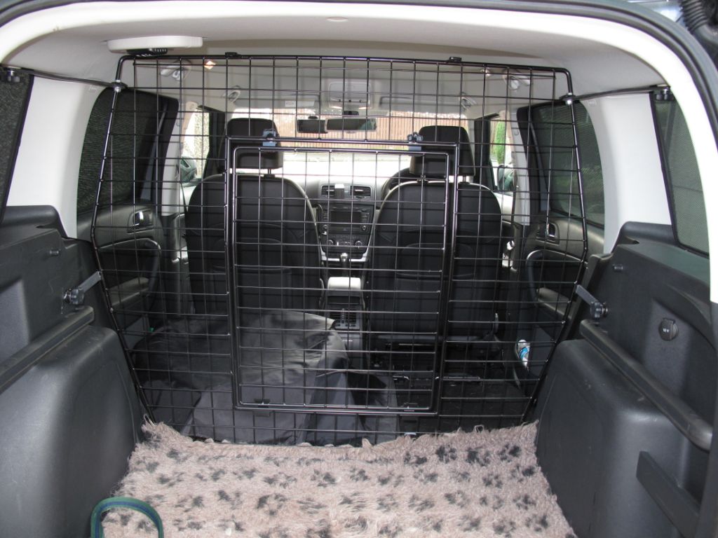

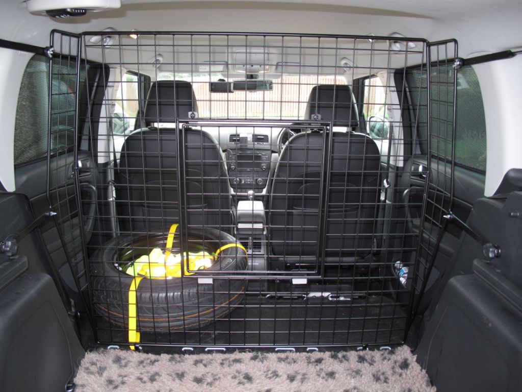

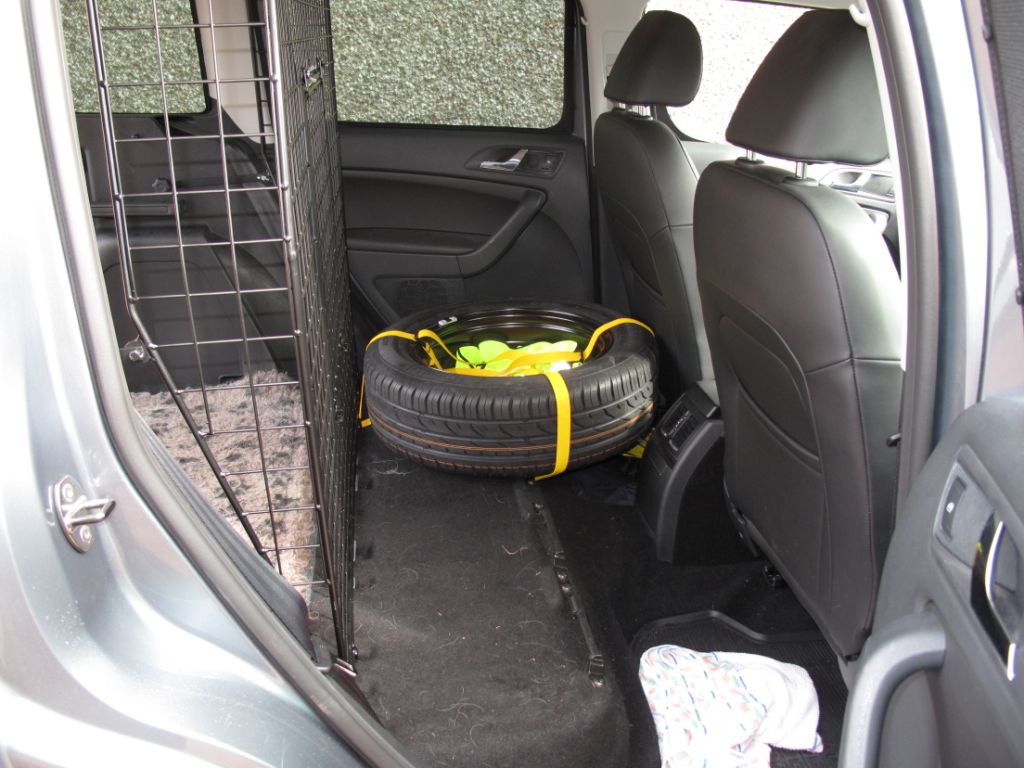

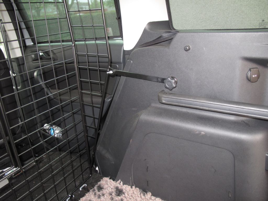

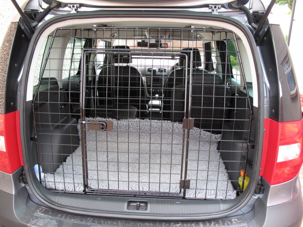

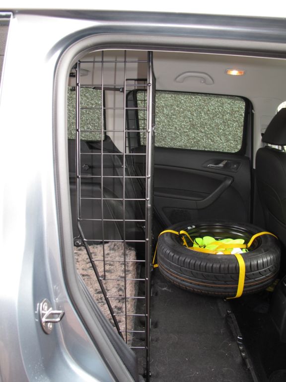

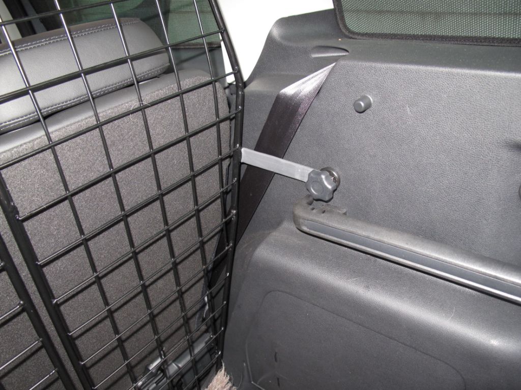

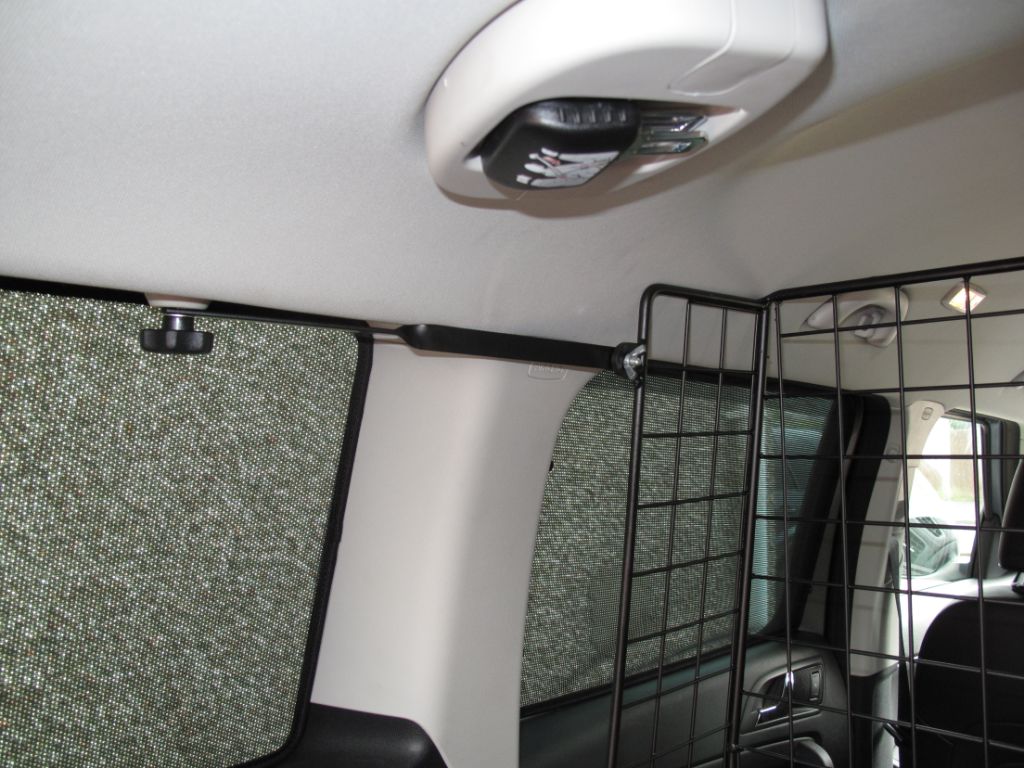

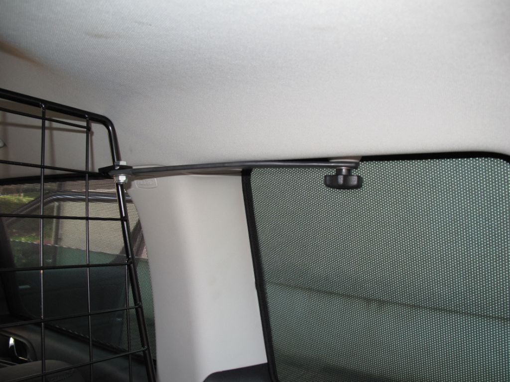

Hi,
when I got my Yeti I ordered it with the OEM luggage restraint / dog guard fitted. As a restraint it is indeed a great bit of kit, very robust, I however wanted to transport dogs in the back of the car and found that it compromised useable space in the top half of the boot as it slanted rearwards. Having a need for two seats only I was able to "lose" the rear three and had a couple of full length guards with escape doors fabricated using the existing restraint fittings at roof and mid level and the seat mounts at floor level. One fits further to the rear and allows me to fit the rear seats if I ever needed them, the other gives max space in the boot whilst still allowing a spare wheel to be carried. This makes for a Very rigid fixing and works really well. I also had a tail gate made for peace of mind. Attached (I hope!) are some pictures for clarification.post-227-0-18254600-1322337919_thumb.jpg post-227-0-97846600-1322337930_thumb.jpg post-227-0-28180200-1322337937_thumb.jpg post-227-0-09295500-1322337947_thumb.jpg post-227-0-41865900-1322337954_thumb.jpg post-227-0-79439200-1322337967_thumb.jpg post-227-0-83432400-1322337974_thumb.jpg post-227-0-95918400-1322337980_thumb.jpg post-227-0-79439200-1322337967_thumb.jpg post-227-0-83432400-1322337974_thumb.jpg
