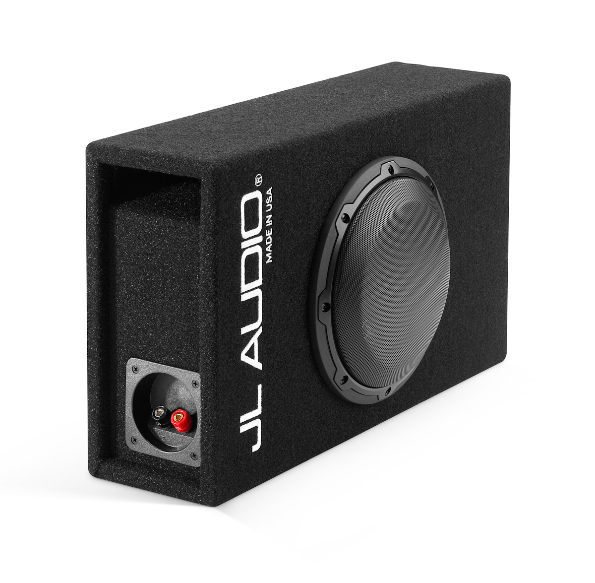

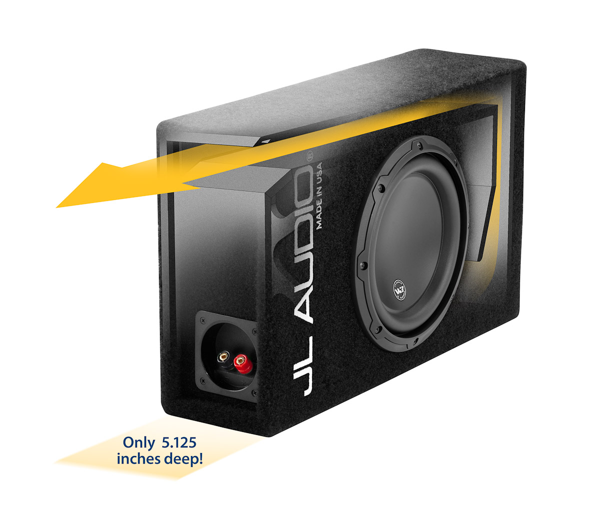

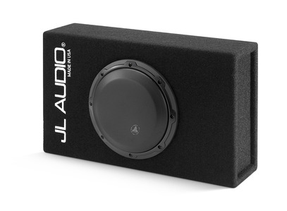

300 quid for whole setup(including sub). I mean I can go without sub, it just a question where to put it. I don't want ANY box in me boot. So if I can get shallow sub in side compartments, I might go for it.

The shallow fit one you linked looks pretty good, comes in around 4" should be poifec'.
