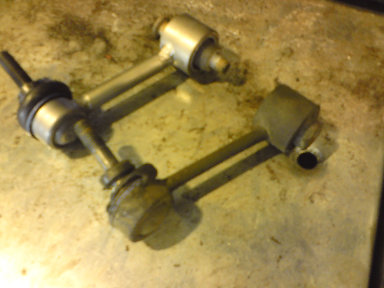

Went to Larkspeed today and they ARE 4090 part number :thumbup: went to ABC again, to book in, he jacked the car up had 3 drums in the boot and two guys in the rear, and then one guy sat on boot sill bouncing to try and recreate the noice I am experiancing. Peter was underneath with a stethescope on each part of the rear suspension . The noise is from the droplinks( going to get performance ones) and one pair of bushes, going to replace with poly ones . He is such a proffessional I mean by doing this he will have saved me not only a huge amount in bushes, but his labour time as well, I have never met a more honest and likeable guy in his line of work . will post some pics up when I get them on (and dampers next week) :yes:

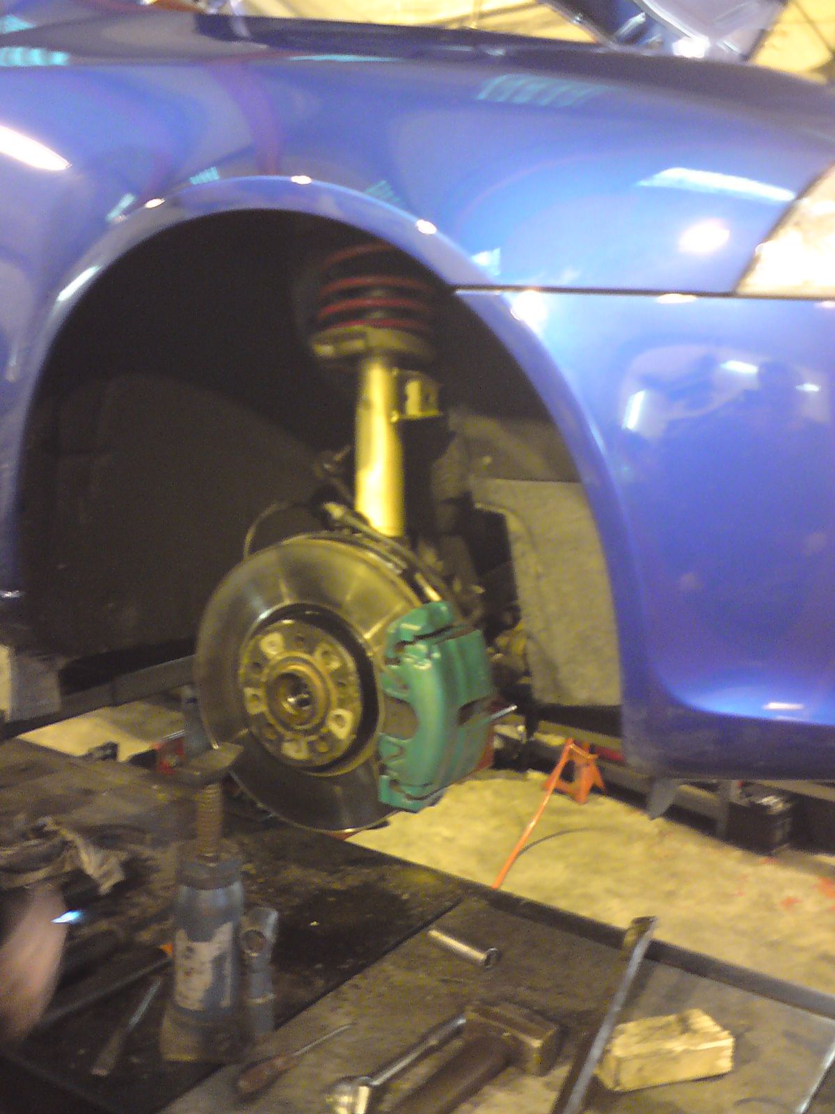

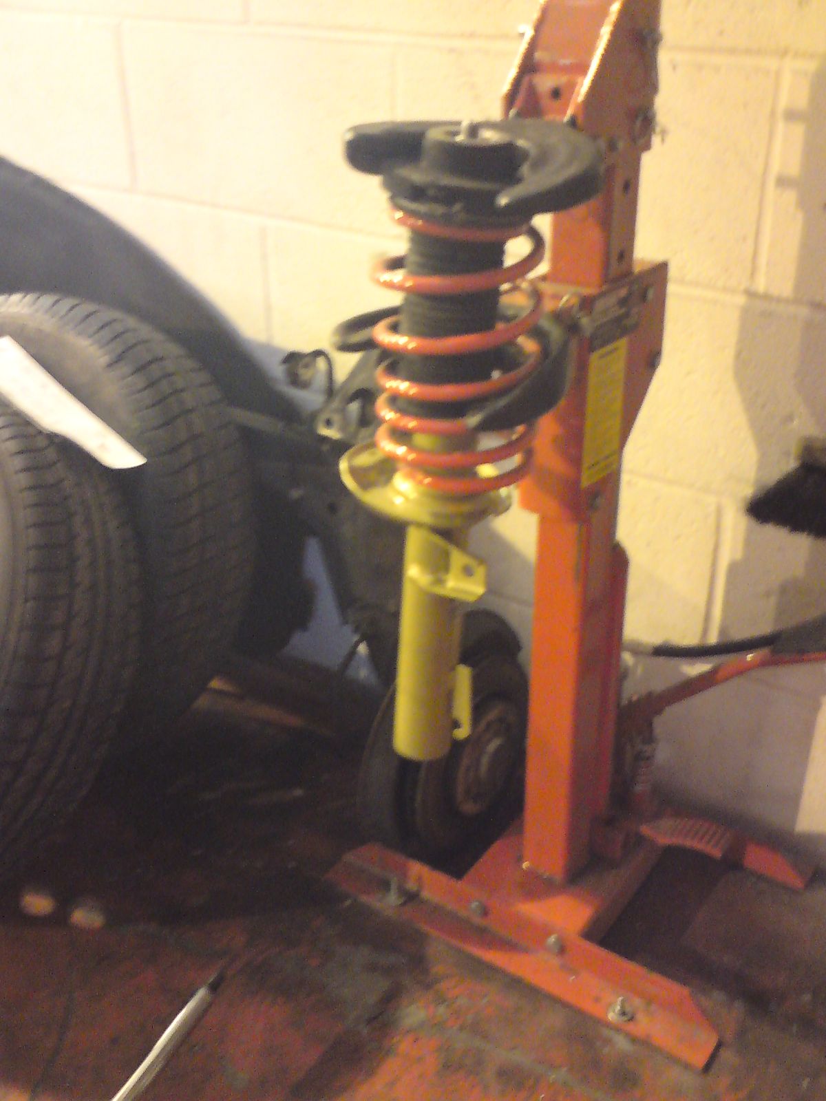

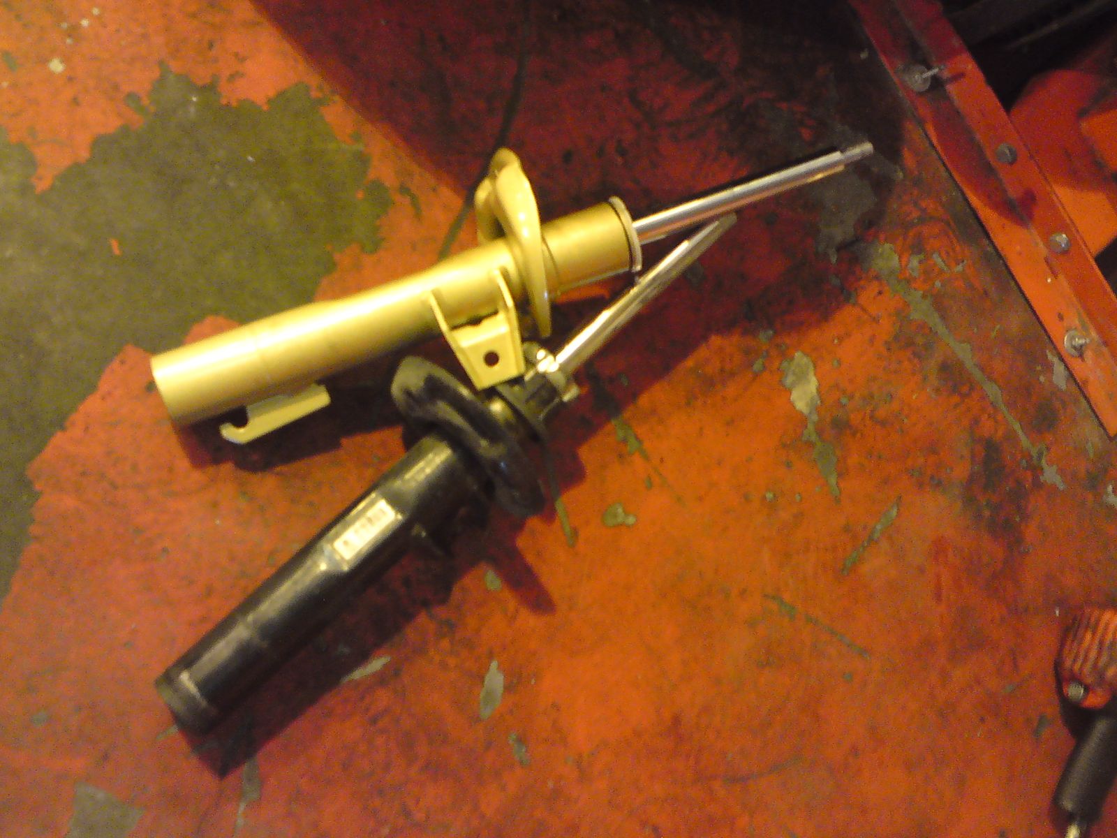

Well I had my droplinks fitted, new bushes and Koni fsd dampers today. The difference is staggering. Thanks to Peter once again at ABC for his magic , one bolt sheared off whilst doing the anti-roll bar bushes. Great some ride and sublime handling now, a few phone pics , not the best old, and new
post-53584-0-71838000-1326992424_thumb.jpg post-53584-0-68072800-1326992436_thumb.jpg post-53584-0-90096500-1326992445_thumb.jpg
Bet your well chuffed now. Did you fit standard oem droplinks?
Yes there are no perfermance ones apparantly, but if you see the photo of them they are double in diameter, so much more beefy anyway and better rubber on them :thumbup:
