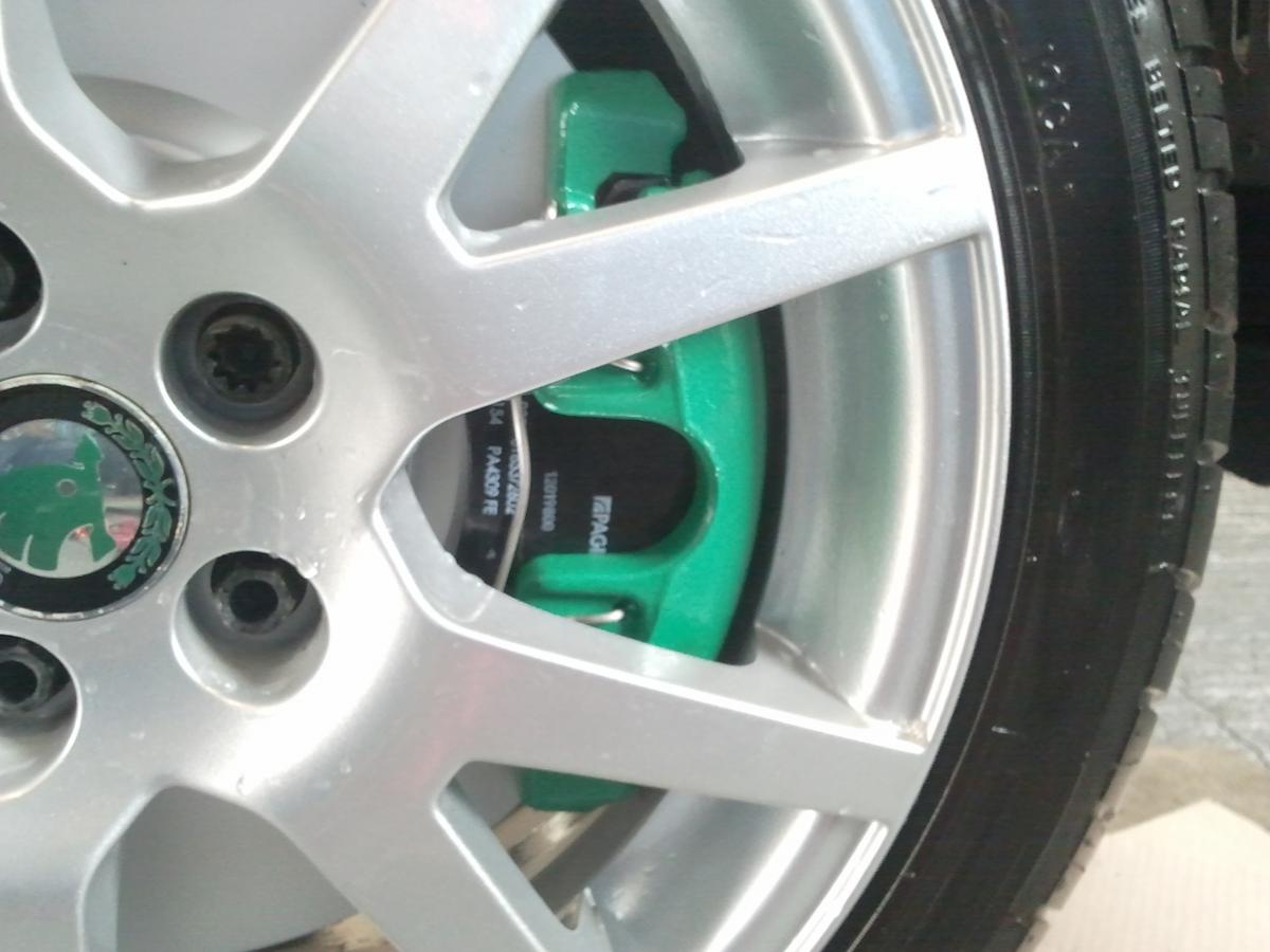

Out of interest do these fit under standard mk1 VRS wheels?x
Yes
Standard 16' wheels are fine with 312's, I run 17' TT comps most of the time.

They're a close fit! I need tp pull my finger out and get mines fitted :giggle:
They are a tad close :giggle:
Get them fitted dude you will love them.

I'm going to fit 40 groove standard size rear dics and oem pads to go along with the 40 groove fronts.
Fronts and rears ready to go on
