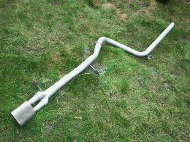

Got any pictures?
I have one of the exhaust before it went on. Ill try put it on.
THIS IS EXHAUST AFTER SOME SANDING DOWN TO GET LITTLE SPOTS OF RUST OFF AND SPRAYED ALUMINIUM SILVER WITH HIGH TEMP ANTI RUST PAINT.post-68315-0-24571500-1331125705_thumb.jpg
tidy work.
alot different from mine, i just had my 2.5" fitted to my original exhaust just behind the rear axle.

Found problem. The weld around the pipes in original tip is crap. Got gaps basically think its leaking into it and acting as amplifier as the tip material is really thin.
Long term replacing with single pipe and oval tip (still work out cheaper than having it done to my own exhaust, thankyou ebay), short term got bout inch of steel wool at ebd of tip held in by mesh. Pic later
