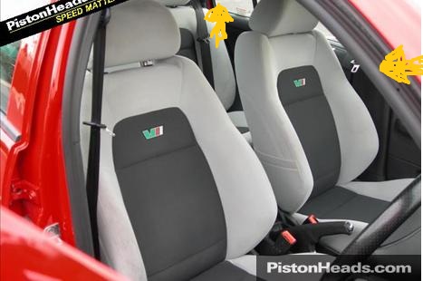

hi all this might be on forum already but ive looked but couldnt find the smae leak as mine ha ha post-81009-0-71325800-1332100778_thumb.jpg
as you can see the rubber on door seal ,ive put yellow arrows for you to make it easy to help me .
heres another picture of door closed but its the drivers door leaking no passenger side
the yellow arrows is were water coming in ??

The water dripped in by the top of the door off the rubber .
