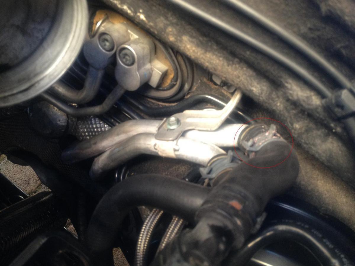

Well had a look this morning. After takingg the car out from the garage I noticed pink water drops under the car and looking under the car I noticed the cross member was all wet, right under the rear of the engine.
I thought it might be the heater matrix so had a look down the back of the engine. I noticed one of the rubber pipes had pink crystals (see pic) on the metal clip with a small split in the hose there was also pink water marks where water had run down the matrix pipes. Hopefully that will be the problem but had to order the hose so I will see tomorrow.

There were several posts previously, it turned out to be where the heater pipes go through the bulkhead and was dripping down onto the exhaust, thus leaving no trace of where it came from.
