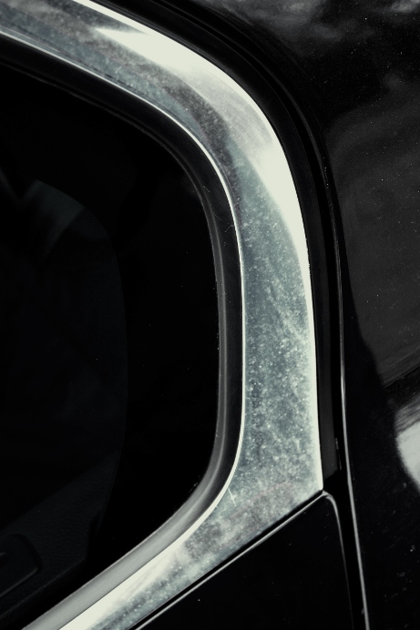

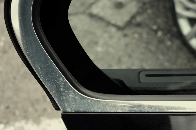

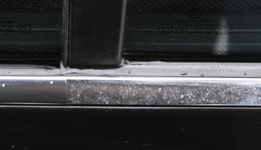

Same deal goes with the chrome ornaments that lost their silver bright look, especially the one from the rear doors, This issue is not yet official accepted to be corrected by Skoda but the problem is well known remaining on the dealers decision to react to the owners complaints.
You can see the diference at the junction while all other chromed parts are in excellent condition. This is just a small bad luck while the car runs excellent after 60.000 km.
