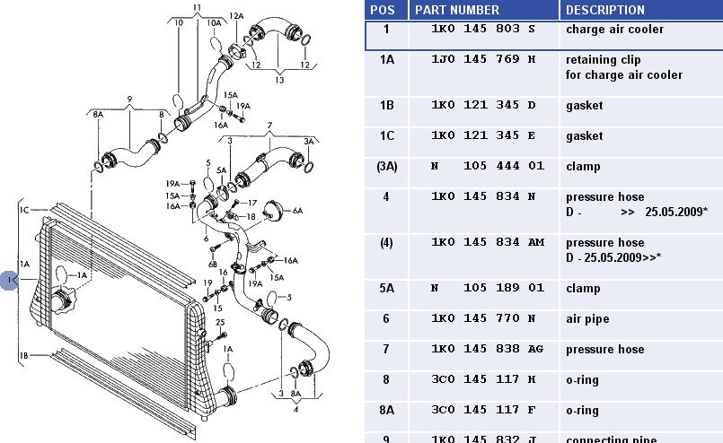

Wondering if an S3 intercooler would be safely enough also or whether it should have something more manly?
realistically, S3 would be fine, considering our climate over here. obviously an APR one would be better, but I cant imagine you doing much track racing in a Yeti tbh, Im off now, as we are going OT.
If I'm being totally honest, an S3 intercooler would probably be fine, but having no experience yet of discombobulating the front end of a Yeti, I'm unsure if they use the same setup. I'll have a gander through ETKA a little later and see what I can dig out :)
Looks promising! :)
I'd imagine most 2.0TFSI intercooler kits will fit on. So the S3 core should be fine. It may however require a couple of pipes to make the connections!
Yeti = Push/Snap fit Clip fitment
S3 = Slip over / Jubilee clip fitment
