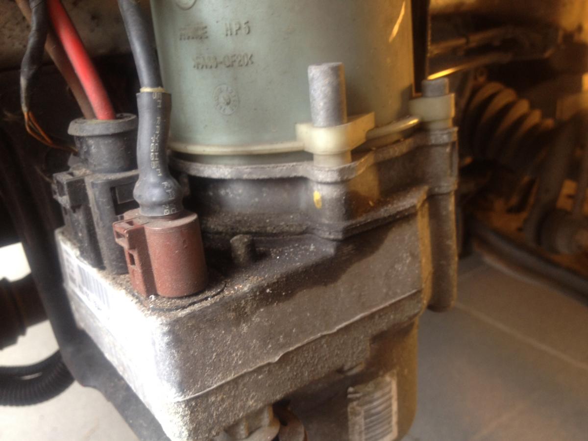

Ok I stripped the car down this morning and got a look at the steering pump.
Cant see any broken wires but there is a few wires that go to ground and they look a little corroded so will clean them up.
What I did notice is what looks like a small leak. While there is no actual fluid around it looks like its been weeping over time (see picture) is where a leak would occur if the fluid was to get into the brains of the device.
Lastly the part number is 6Q0 423 155 AH and its a KOYO which after some time researching is like rocking horse poo.
Whats the advice here should I just swallow and try and find one and replace it, from reading on here it seems like its a part that will go eventually no matter what so wondering if I just replace it at least I shouldnt have to worry for a while.
