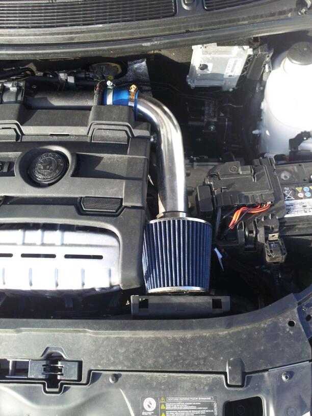

Here we go guys i think it fits nicely, well here it goes dont know how these are gonna turn out:
Watch for heat soak as thats right next to the turbo/exhaust so it will be taking hot ait straight from there so youl probably be loosing power
Sorry to be negative but won't that cause a power loss? Due to all that heat being sucked in, as it's known these engines run hot in there.
You seriously need some sort of heat shield on that filter
I've got to agree with the comments, a heat shield is needed as it will be suffering from heat soak

yea thought i might get affected by heat but not at the moment got reader for ecu so gonna read inlet temp's tomoz while driving, got idea of what inlet temps are like when running standard and if its much greater will be going back to standard for now.

ebay has plenty of heat reflective tape any1 knows if it worth giving it a try can get hold of a sorta enclosed cone filter might help if not fully enclosed should do job, do air filters that look lyk itg work just as gd i.e rr read out comparing???
