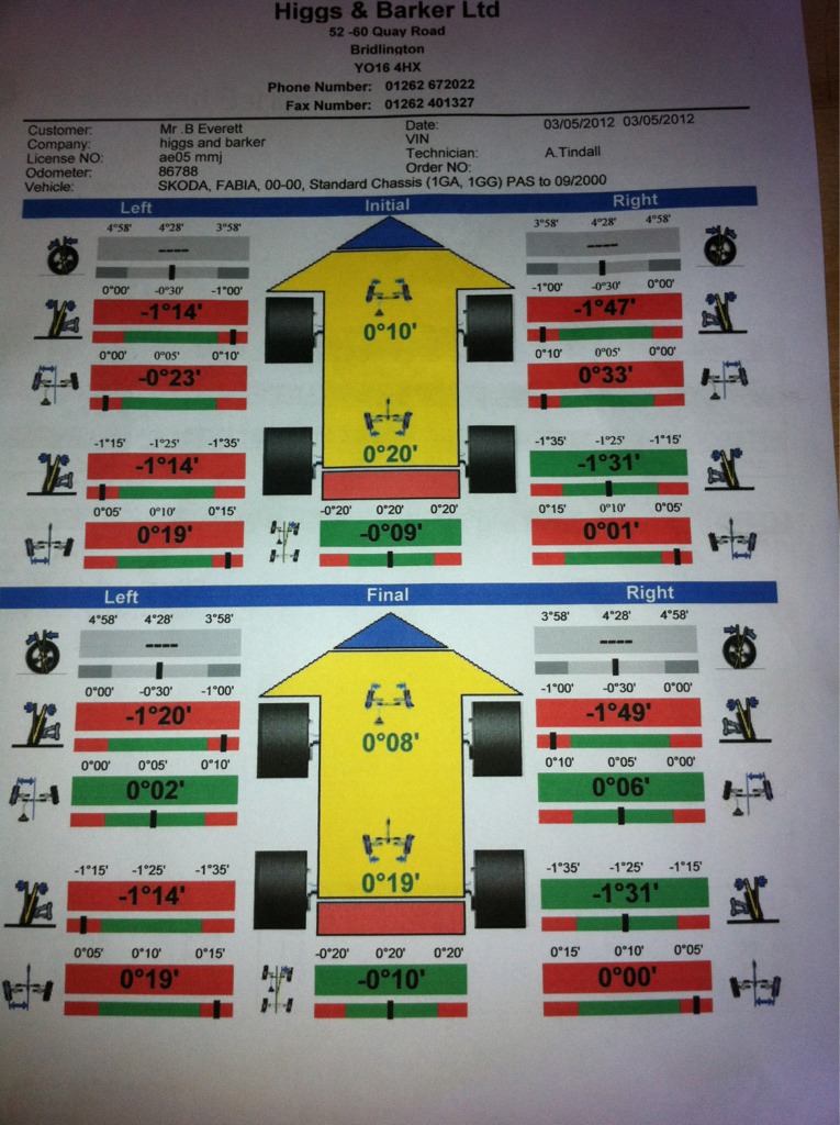

This is the printout I got, I have no idea how to read it but I'm guessing by the - numbers it still isn't good? Lol
NSR looks to be in bad shape from what I can tell.
This is what mine shows
It does look typical for Fabis after lowering sustension fitted. But I can see few mistakes. First of all they havent check caster on front (despite no adjustment) but its good to know if there is anything wrong with subframe.
Second problem and I think it is a problem that rear thrust angle. -0.10 is very high and will create big sawtoothin on left rear tyre and excesive inside wear on right right. To me it looks like it was damaged on left side or something made impact on left rear hub. Worth getting second opinion on that.
Front toe set alright. Overall to me it seems as they done a job worth £25-30 on equipment worth doing better job.
