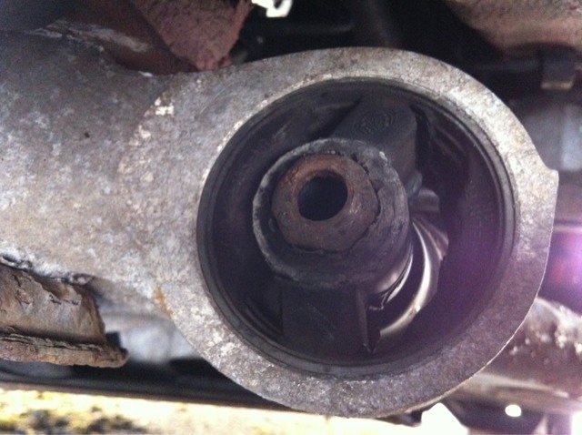

Thanks guys, car is back now and from what I can see the standard bushes that are in are fine for now. I'll work round the rest of the bushes by process of elimination to find the knocking.
Thanks again
If the console bushes look like that they're knackered, if it's not them the only other bush it's going to be on the front end is the ARB bush but I'd check the drop links first.
