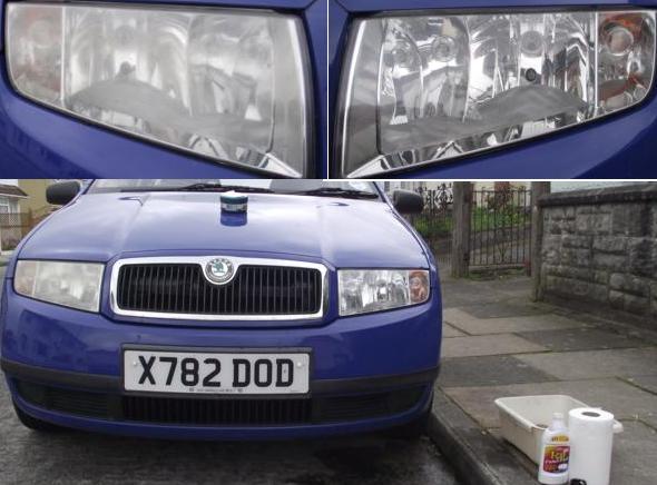

To my surprise something has gone well with the car. Only done one side. Wet and dry, 600, 1000, 1500, 2000, T-Cut, Turtlewax.
