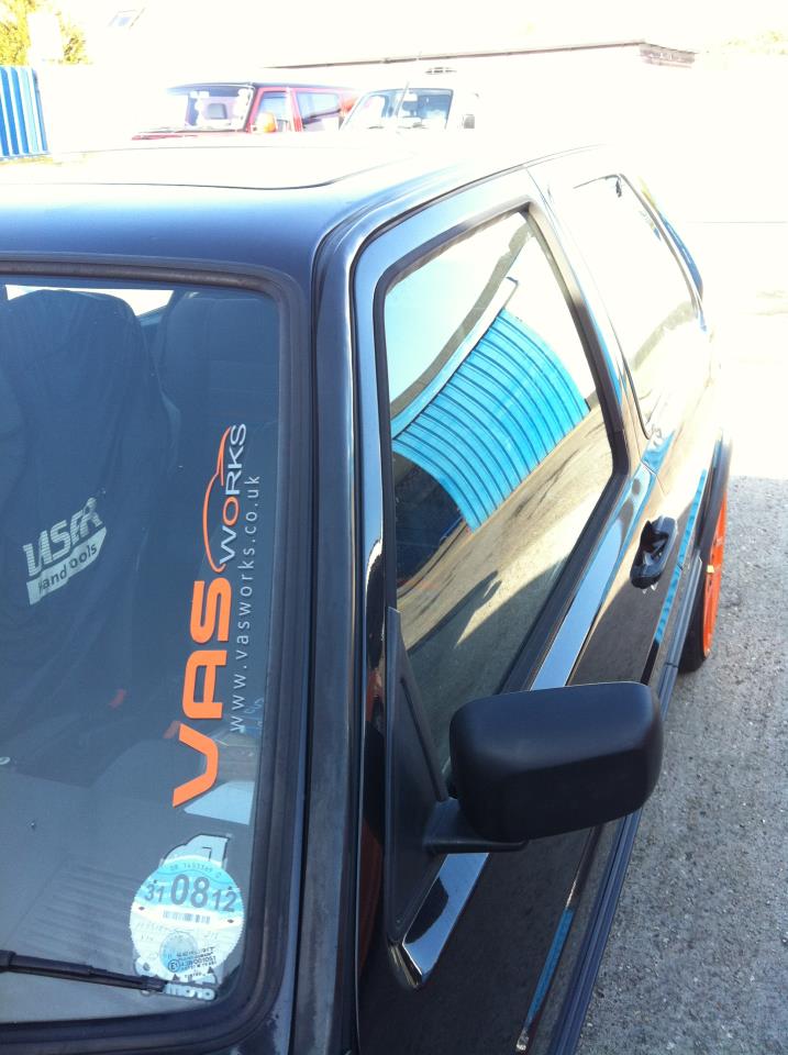

They have loaned me one of their cars, so today I am driving around in a modified 1991 VW Golf GTI 16V. This car handles really well for 21 years old, well it should as its sitting very low on coilovers and has quiet large orange painted alloys. Mileage is unknown as the speedo does not work, so need to use satnav as speedo.
Side view picture of Golf from their facebook page.
I'll not take anymore, but you get the general idea.
