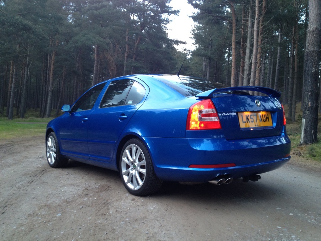

So I got my new vrs, 35k on the clock, pd170 diesel with cruise maxi dot and Xenons.

It's a late 07 flew to London to drive it back up to Nairn, that was a long day but that diesel lump just ate up the miles, loving the car.About the loom, is it really not included in the recall and why does it need changed, just trying to arm myself with as much information.
