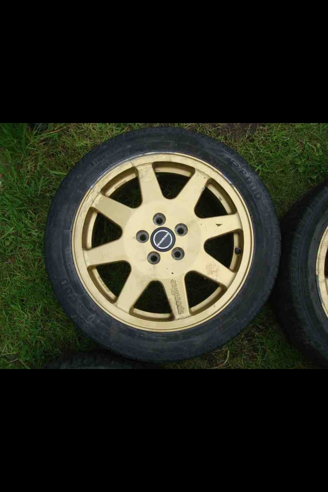

post-74987-13385432906959_thumb.jpg that's the wheels there dead cheap that's all
When I chopped in my OZ Superturismo's to pit8ull they were from a scooby and I had the centre bore re-bored to suit VAG.
Has to be a classic shape scooby for them to fit as newer ones are 5x114.3.

Well, not quite... :)
Anything before the MY2005 STI. Classics, bugeyes, blob eyes, even hawk WRXs are 5x100. Though the bugeye onwards STI had wheels with a slightly "friendlier(!?!) offset of 46 or thereabouts as opposed to 52 or thereabouts.
