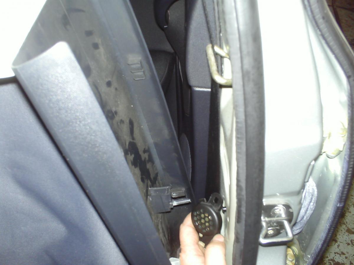

Quite easy to remove buzzer when you know where to look
N/S B pillar, trim un pops buzzer located behind seat belt  :rock:
Well I'll be blowed!!
Cheers stoaty, and welcome to Brisky too.
I'll have a look in daylight once it stops raining.
