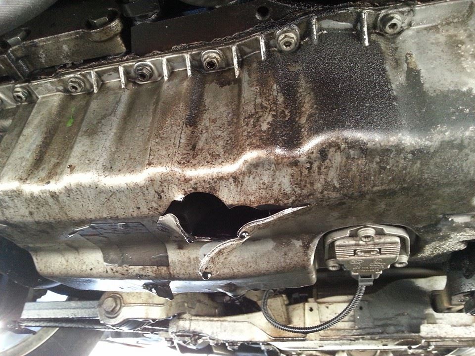

Hi, we've been amazed at the amount of stories found on forums concerning the BXE engine. Ours went last week, the con rod breaking then the crankshaft blasting it through the bottom of the engine, the jolt of the engine broke the exhaust brackets and the turbo is screwed too, all this whilst driving in the outside lane of the M40 on a Friday afternoon! Sales and service staff at our local Skoda were very unhelpful, offering us £1000 for our 2009 Octavia estate, bought from them at a year old and serviced regularly by them!! One of the mechanics came and spoke to us on the side and mentioned that he has seen this problem before, but never quite as bad as ours. If I can figure out how to post a photo I will. Anyway we shall be making a formal complaint and as Skoda want 6k to fix it we shall be looking for an engine ourselves and getting somebody else to do the job. Being faithful to Skoda has got us nowhere. I can say we'll definitely be getting in touch with DVSA to report this and can only urge others to do the same.post-117372-0-66918700-1400341522_thumb.jpg

Mine went two weeks ago whilst on the commute home, started with the whole car shaking (as if a tire had burst) so pulled into a petrol station and got the car towed home by the AA. Left it with a VAG specialist, and whilst they were examining it No 4 conrod burst out of the sump. My car is an 07 Octavia Elegance 1.9 TDi, with approx 102,000 on the clock, which is now useless as to install a new engine from Skoda would be around £5,600 and only £1k less for a recon, I'm not doing either as if the engine was OK it would only be worth around £3,800 or so.
So now I'm stuck with a well looked after Octavia Elegance with a shot engine that I need to get rid off :( (I'd like to try and get some money for it as it's in good condition, only had new rear disc last year).

Of course the VAG specialist garage would rather make as much profit as possible, whilst retaining their good reputation, but they really did try and put the fear of God into me regarding bargain basement recon engines being fitted. I'm twitchy about spending £1.5k with a potentially dodgy business and ending up with a engine that's more trouble than it's worth (not a true recon, just spat on and polished).
Where about are you, maybe get a short engine block and diy it. Maybe someone local could assist? If anywhere near me I would be happy to help out but am no expert. Any engine swaps I have done have been on CVH Ford's and A series minis. Hopefully someone with a bit more knowledge could help.
