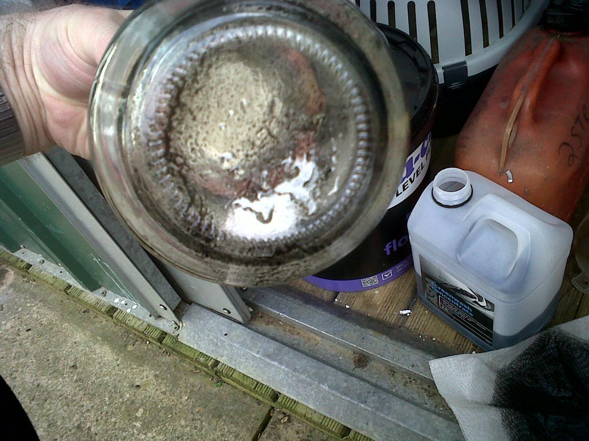

This is the black bits left in the bottom of the jar I put the fuel in,as you can see there is quite a bit.
Trev
Trev
Is it oil?? :unsure:

*UPDATE*
Looks like it IS the tandem pump,bit the bullet and got a new one,cost £213,fitted it in 10 mins,now got better fuel consumption,better pickup,so must have been on the way out,however on stripping old unit (just to see how it works),there's an oilseal in the middle of the pump between the diesel part and the vacuum part now I think this is the weak link,also did notice wear on the rotor of the diesel pump,and the vacuum part was covered in engine oil,I know it lubed by the engine,but it is just the seal or the vacuum pump?,just waiting now to get rid of the black fuel in the tank before I change the filter (to dear to waste),will update when I change the filter.
